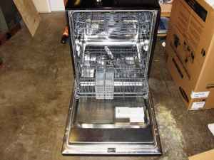

It's back again. And (down to?) $75.
Looks like they're having as much trouble unloading this machine as I did trying to pass along the refurbished 25 year-old Thermador THD 3600, which still sits in my garage.
Does anyone know if the black panels can be switched out for stainless? Here's a shot of the interior, which may not have been included in the previous CL listing for this machine last month.
CLICK HERE TO GO TO rp2813's LINK on San Francisco Craigslist |
Post# 510549 , Reply# 11   4/10/2011 at 06:29 (4,758 days old) by brisnat81 (Brisbane Australia)   |   | |
Hi Ralph, On the early 80's models yes, on these, no. Panels are not interchangable with anything. See if you can talk them down further, these machines will clean anything. Nathan |
Post# 510651 , Reply# 12   4/10/2011 at 15:57 (4,758 days old) by rp2813 (Sannazay)   |   | |
Thanks Nathan.
If it can't be switched to stainless panels, that won't work for me. Plus, I think the stories about the control panels going out is enough for me to let somebody else have this machine.
The sellers are clearly having a hard time, so I wouldn't be surprised if the machine shows up at a Habitat Re-Store at some point. |
