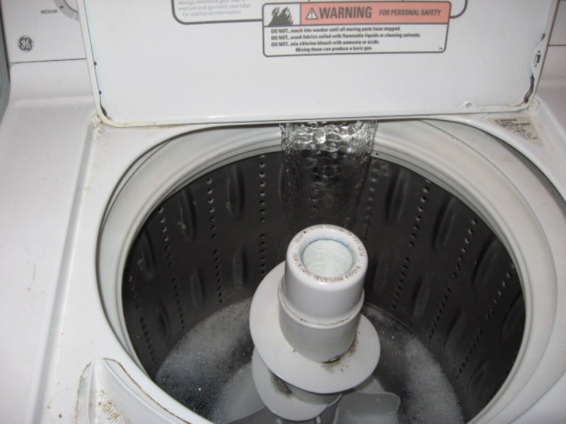

The inside of the washer. Stainless steel tub with tall agitator. |
Post# 503130 , Reply# 4   3/10/2011 at 21:53 (4,794 days old) by pingmeep ()   |   | |
I've seen some machines do that when the hose filters are clogged. Mostly happens on the hot side with a lot of build up. Easy thing to check out. |
Post# 503134 , Reply# 5   3/10/2011 at 22:12 (4,794 days old) by cfz2882 (Belle Fourche,SD)   |   | |
i also have had inlet valves buzz with plugged screens or low water pressure. Could be something wrong with the valve too. |
Post# 503155 , Reply# 6   3/11/2011 at 01:35 (4,794 days old) by volsboy1 (East Tenn Smoky mountains )   |   | |
My G.E. Harmony does it also..Its like a buzzing/ squealing sound they told me it was normal and sense that washer looks like it fills like mine does.The biggest no no from what he told me is to shake/or mess with the pipes cause of mineral build up. I am just guessing though my Harmony is made by L.G. |
Post# 503367 , Reply# 7   3/11/2011 at 18:35 (4,793 days old) by cornutt (Huntsville, AL USA)   |   | |
My Harmony doesn't buzz like that. It's either a bad solenoid on the valve, or the triac that switches it is on the way out. |

Post# 504428 , Reply# 15   3/15/2011 at 23:44 (4,789 days old) by Andy (Mount Vernon)   |   | |
It's the cold side humming the loudest, but warm has hummed loudly, too, in the past. Like I said, it comes and goes. CLICK HERE TO GO TO Andy's LINK |
