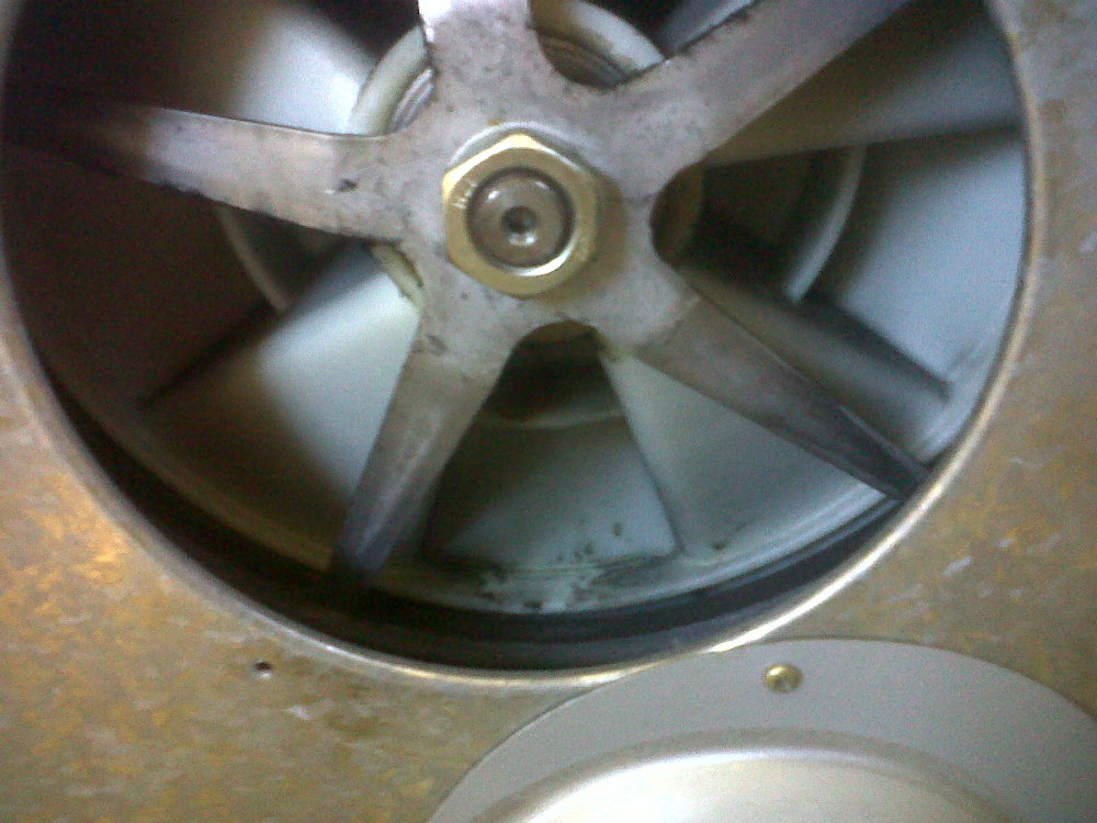

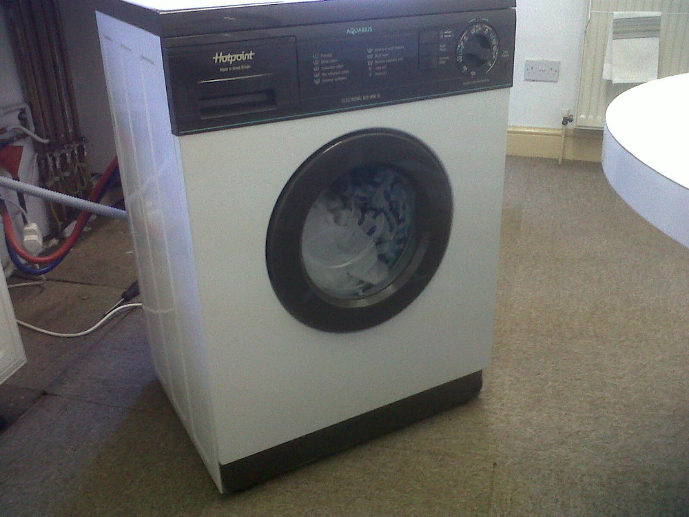

Post# 505216 , Reply# 1   3/19/2011 at 16:46 (4,785 days old) by SuperElectronic (London, UK)   |   | |
Having popped the hood and removed the backplate, I suspect the following is sign of seepage from the bearing... |
Post# 505328 , Reply# 4   3/20/2011 at 08:24 (4,785 days old) by hotpoint95622 (Powys)   |   | |
How long have I got;
It’s a job to know, don’t let it get too bad, as the drum can start rubbing on the heater or the front lip of the tub front plate, which can increase the cost of repairs, you can also get rust spots on your whites as the rusty muck leaks back thought the knackered bearing seal which is why the bearings have failed. 15 years hasn’t she done well? If you have it done I would have the shaft/spider changed as well as the bearings/seal. |

Post# 505522 , Reply# 7   3/21/2011 at 01:17 (4,784 days old) by SeamusUK (Dover Kent UK)   |   | |
Hey Al
You may just about get to early May, but if it gets any worse id advise temporary substitution of the Proline... Id ALWAYS get the spider changed on one of these as well as the bearing unit. Regarding price Hotpoint have a fixed price repair service and they dont stipulate a maximum age- think its around the £100-110 mark, or you might be better off phoning round your local repair places for a quote. Or you could ask one of the lads up country if they fancied a weekend in London lol...... Just DO NOT send it to the tip :) Seamus CLICK HERE TO GO TO SeamusUK's LINK |

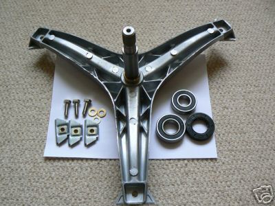

Post# 505687 , Reply# 13   3/21/2011 at 18:40 (4,783 days old) by chestermikeuk (Rainhill *Home of the RailwayTrials* Merseyside,UK)   |   | |
Hi Alex
Pity we wernt nearer, could have had a workshop experience!!, the parts are very reasonable, £40 quid for the complete spider & bearing kit on fleebay!! CLICK HERE TO GO TO chestermikeuk's LINK on eBay |

Post# 506694 , Reply# 49   3/25/2011 at 10:07 (4,780 days old) by chestermikeuk (Rainhill *Home of the RailwayTrials* Merseyside,UK)   |   | |
Was booking a service call for a fan oven and asked about fixed price repair of your said machine - I think its an excellent deal
£135 for a fixed price repair - bearings & spider - AND anything else neede to make the machine usable (so if he found pump knackered, then you will get this) AND - This is covererd for 90 days - Alex you may find a local repair out of london could do it cheaper but I'm not sure for where you are.... Like I say you would be hard pushed to find many other Service Departments offering that type of service these days!!! |

In reply number 13 which Chestermike posted, there is a picture of the complete kit, tell me do these look like second hand/refurbished parts, you know it is possible (in this country at least) to obtain genuine parts for older machines relatively cheaply.
The thought that anyone would attempt to remove bearings and seals (providing they dont damage them doing so) and then clean them up and try and pass them off as new is laughable...................... You really have no idea about repairs in this country at all Regards |

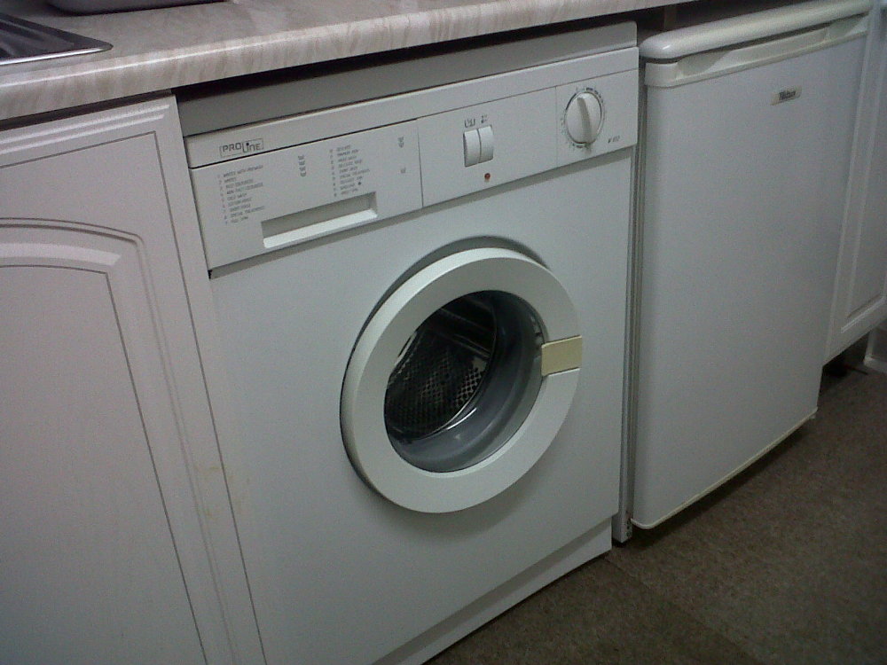

Post# 511083 , Reply# 77   4/12/2011 at 16:40 (4,761 days old) by SuperElectronic (London, UK)   |   | |
...but hopefully not for long! |

Post# 521344 , Reply# 88   5/29/2011 at 19:34 (4,714 days old) by richardc1983 (Leeds, UK)   |   | |
Post# 521693 , Reply# 90   5/31/2011 at 18:18 (4,712 days old) by SuperElectronic (London, UK)   |   | |
....nothing a petrol bomb wouldnt't solve, Liam!
(For a more reasonable precis of the Proline W850, you may wish to refer to my archived posts...) |
