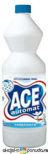

The text on the back of the bottle should hold the instructions for use Chris(aquarius8000) |

About the bottle, here people that work in the store stamped declaration for import over instructions, so I can"t see it :( So, deffinatley COLD and SHORT? :) Then I should doo what Candy said in manual? |

If using a front loading washing machine (H-Axis), then add chlorine bleach (no more than 1/4 I should say) to the first rinse. If you can find make the machine fill with hot water for this rinse, the better, if not then go with the flow. Chlorine bleach does not need to be in contact with textiles longer than five minutes. That is all it takes for stain removal, whitening and disenfection. This will take place faster in hot water, but again long as the rinse cycle lasts about five minutes you should be fine.
Depending upon how many rinses your machine has, after the final rinse restart the washer again and set it to another final rinse. This time add 1/2 cup of white vinegar to counter act any remaining chlorine. If your laundry ever still smells of bleach, it is not rinsed enough and there is still bleach left in your clothing. Chlorine bleach is hard to rinse and cotton in particular tends to hold onto the stuff. If not rinsed properly the bleach residue will cause textile damage. This is the holes and such people refer to as being caused by bleach. Quite honestly if your washer is capable of doing a boil wash, I'd skip the LCB and do that with extra oxygen bleach added. |
