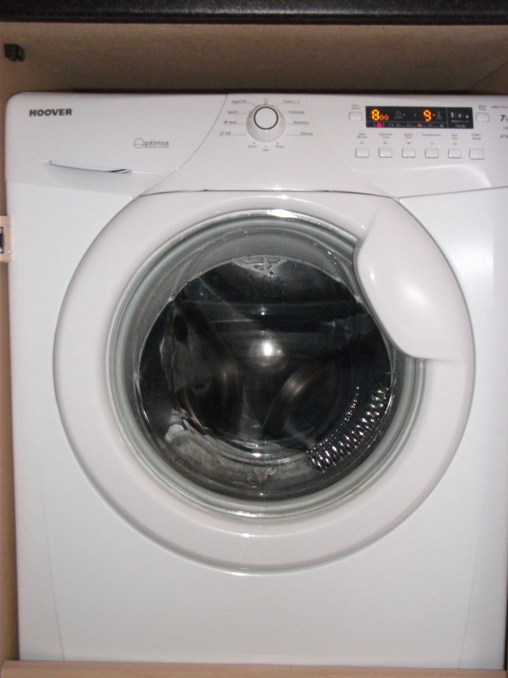

Hello Everybody. This is my very first post on automaticwasher.org. I have been visiting this excellent site for quite a while now & i have finally got around to joining the group. I have worked in electrical retail for almost 15 years now. I work in a small but very busy independent shop that used to be a norweb shop. We sell all the major whitegoods. I do the ordering,selling & the deliveries & the fun part picking up the customers old appliances. You would not believe some of the classic washers we pick up. Just a few weeks back we delivered a washer to a customer & I could not believe my eyes when he wanted the old one taking away a Hoover OPH714D. I asked him what was wrong with it he said it wasnt pumping out. Well here it is now in my kitchen working perfectly & the problem a blocked pump sorted it out in minutes.

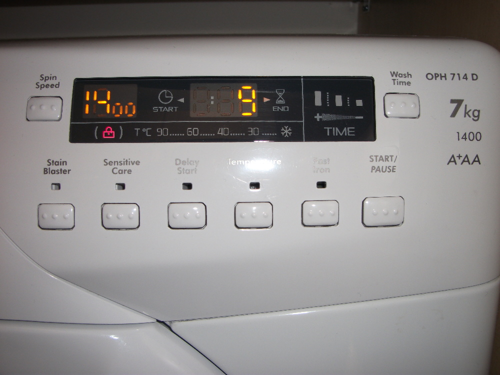

Now for plus & negative points. (The plus points) It does a very good wash on the 29 minute quick wash i like the long drum rotations. I like the real time lcd display. The wash time button you tell the machine how long you want it to wash for. Very deep rinse water levels. Low level fab con rinse makes the most of the conditioner. Fast 1000rpm interim spins. (Negatives) No 50deg temperature option. Dont like & dont want the prewash before the 90deg programme. If you want to do a prewash it should be as a option button. Quick wash 800 max spin i would like the option to increase this. Fast iron button a waste of time its quite simply rinse hold. A bit to fussy on spin balancing. Final 1400 spin takes far to long. No slow drum rotation at the end of the final spin. All in all i quite like the machine.

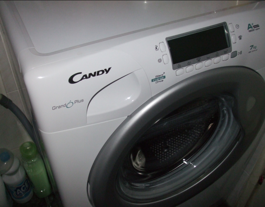

Post# 514380 , Reply# 28   4/28/2011 at 12:05 (4,740 days old) by optima (Cumbria England)   |   | |
Dex, That Grand O plus is a stunning machine. I would just like to know one thing & its about the silent inverter drive can to tell me if its a brush motor or a brushless induction motor. For the first time last night & it has not done this before i have just found out my oph714D Optima is even more cleverer than i though & its to do with the out of balance sensor. After it has pumped the wash water out & it goes up to distribution speed. It then senses the load balance its either a case of another re-balance or spin but last night it spinned quite out of balance for the 2 400rpm bursts thats when i started to panic thinking my washer is going to shake itself to death then it realised before going onto the faster 1000rpm bit but up till now it would sense before the first 400rpm spin burst. I found that rather clever.
