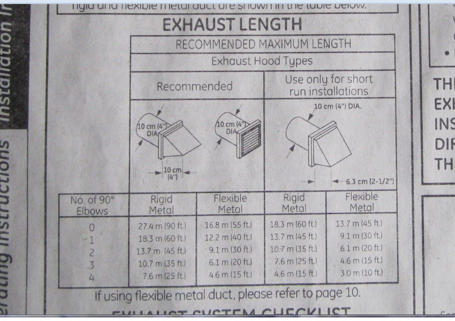

Post# 514217 , Reply# 6   4/27/2011 at 18:04 (4,746 days old) by the7 ()   |   | |
Please note my GE is of the new style (not of old style from Frigidaire). See diagram attached. |

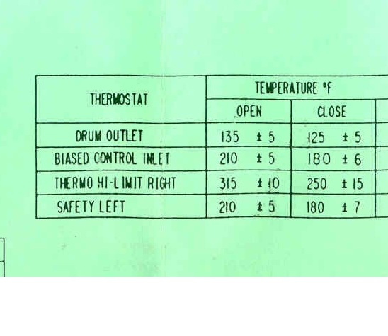

Post# 514381 , Reply# 11   4/28/2011 at 12:06 (4,745 days old) by the7 ()   |   | |
Thanks combo52 for the valuable info. It seems there are two heating elements in the GE 7 cu ft dryer. Wonder if you know the wattage of them and why it uses two instead of one? |
Post# 514666 , Reply# 13   4/29/2011 at 20:12 (4,744 days old) by DADoES (TX, U.S. of A.)   |   | |

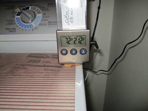

Post# 516898 , Reply# 17   5/10/2011 at 19:03 (4,733 days old) by the7 ()   |   | |
The sensor in the lint tray. |
Post# 516900 , Reply# 18   5/10/2011 at 19:05 (4,733 days old) by the7 ()   |   | |
The digital thermostat. |
Post# 516904 , Reply# 19   5/10/2011 at 19:09 (4,733 days old) by the7 ()   |   | |
It should be a digital thermometer. |
Post# 516908 , Reply# 20   5/10/2011 at 19:28 (4,733 days old) by combo52 (50 Year Repair Tech Beltsville,Md)   |   | |
During periods A & B one heater should not be cutting on and off at such a low outlet temperature, you likely have too long an exhaust system or other problem with the exhaust system. If you want to get the best life and performance out of this dryer make sure your exhaust installation meets GEs recommendations in every way, A bad exhaust system likely contributed to the problem with rusting rear seals on the old KM dryer. |

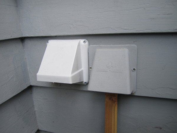

Post# 517273 , Reply# 37   5/12/2011 at 18:50 (4,731 days old) by combo52 (50 Year Repair Tech Beltsville,Md)   |   | |
How long is your vent system and how many elbows are in it? The cycling of one heater so early in the drying cycle does not seem correct. This is one of the major reasons that I have never liked dryers that have the heater elements right behind or right in front of the dryers drum. GE is cycling one heater with the inlet thermostat to keep the rear drum temperature lower to prevent scorching clothing and dryer fires. It would be interesting to try drying a load with the vent disconnected and see if the one heater cycles so early in the drying cycle.
