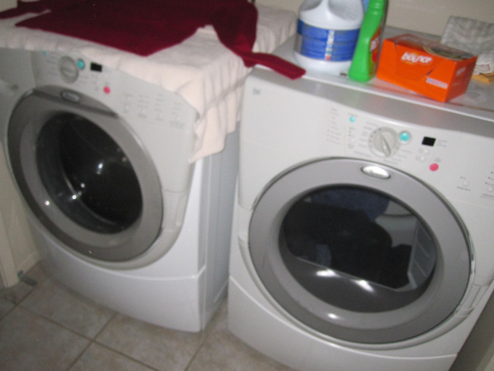

Have you inspected the pump protector screen that keeps stuff from damaging the pump? It might be clogged. |

The "button catcher" is there so that any foreign objects may be easily removed to keep the pump from either failing or needing replacement. It is a good practice to check it every month espaecially if you have pets like dogs,cats,horses or a bear.lol. Not all front loaders have them and the Whirlpool's are not easily accessible.I check mine evry other week and have never had any serious issues other than my x room mate's metal bra strap. |

It doesn't have easy access to clean the drain pump and Whirlpool STILL has not addressed this! I have to take the panel off the front.........I have two cats and amazingly when I check it there's hardly ever anything it it. I check pockets religiously but some stuff has escaped me and gotten in before. Once I washed one of those mini flat head screw drivers. |

As much as I hate to admit and as much as I claim I admire them,the Frigidaire front loaders, as well as the Electrolux,have NO button trap. The pump,if it gets clogged or stuck, has to be completely removed and opened up to remove the clog.That's even more difficult then just removing the three screws that hold the kickplate on the Whirlpools. GE just recently placed one on their models.Bendix always had them and I am sure that's one of many reasons that they are still out there today.
