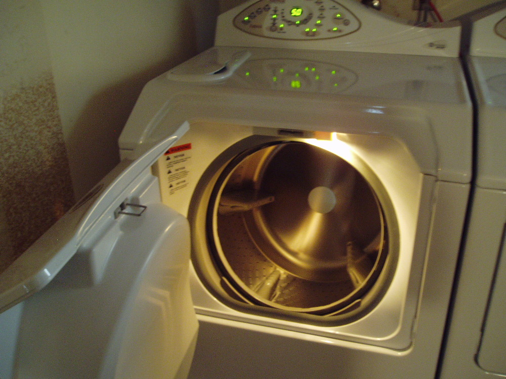

Post# 522182 , Reply# 6   6/3/2011 at 05:42 (4,710 days old) by DADoES (TX, U.S. of A.)   |   | |
There are numerous U.S. washers with onboard water heaters, but they're for supplemental heat, not primary heating from a cold fill.
- "old-style" Neptune frontloaders MAH6500 and MAH7500
- Neptune TL FAV9800 (although they're rare)
- most any HE toploader/frontloader with a Sanitary cycle has a heater ... Samsung models, LG models, Whirlpool Duet and Cabrio, Kenmore HEt and Oasis, Maytag Bravos, KitchenAid Ensemble, etc. |
