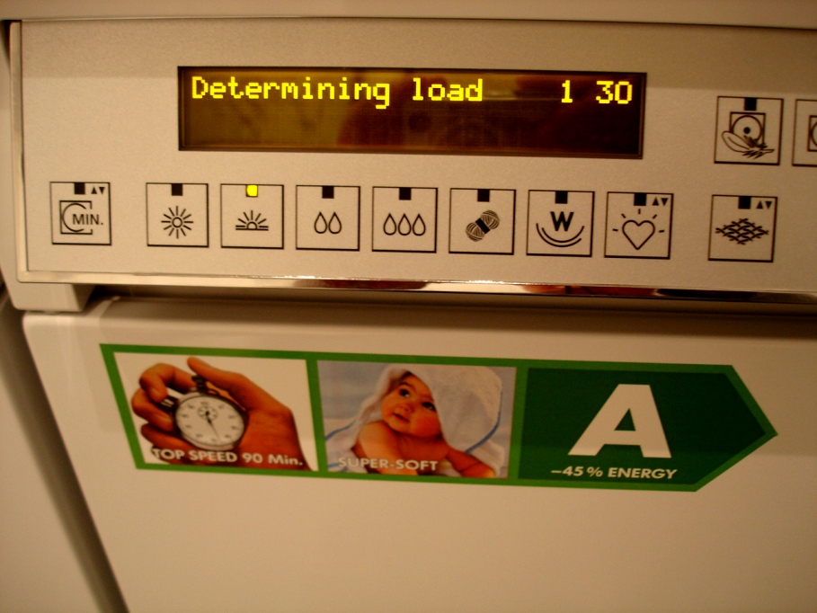

A different operating concept!!! I was most disapointed with the V-Zug Heat Pump dryer when I first got it....with up to six double bedrooms to service most weekends and more bedding & towels before and after the wash-ins I relied on the Maytag or vintage dryers to "Dry Ready For Fitting" etc...so I spun everything fast 1600rpm and many blended quilt covers and bedsheets usually only took 20mins in the dryer..any creases obtained in the max extract spin where lost with the Heat / Steam from the dryer..and I benefited from fast dry times..
With the Heat Pump dryers these work by extracting the moisture left in the clothes by the Heat Pump technology which doesnt use heat, (Very Cheap)but heat does build up by the residual effect (Weird reverse action than a normal dryer that produces heat at the start and then goes cooler) So all this bedding spun at max extract etc never dropped the creases by using the HEAT PUMP EFECT and also the drum never gets warm or heats up like a traditional dryer, the traditional dryer acts like an IRON dropping the creases out of fabrics and they drop onto the WARM/HOT drum. You will have to reduce your spin speed for mixed fabrics, leaving more moisture in them, so less creasing and the heat pump dryer will extract the moisture - you still save on money but you dont on time... With any new technology its a different process, in this case a very different one!! |
