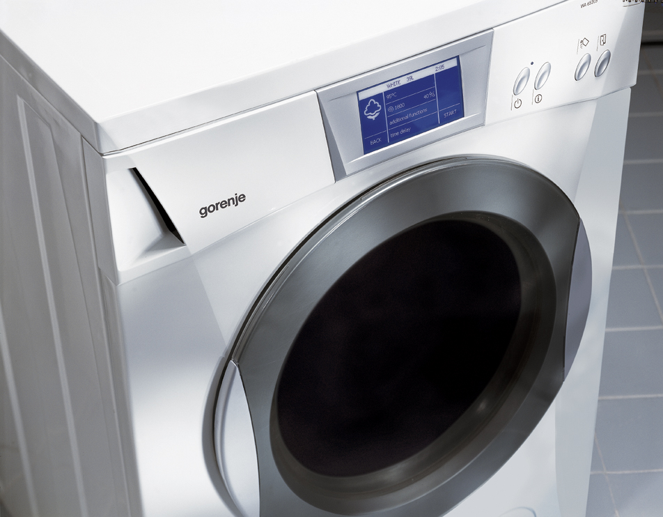

Post# 525614 , Reply# 2   6/19/2011 at 15:28 (4,692 days old) by nrones ()   |   | |
Still, Gorenje's top is 2000rpm, however before the touchscreen models were available only at 2000rpm, now they added touch screen models with lower speeds too ;) Dex |

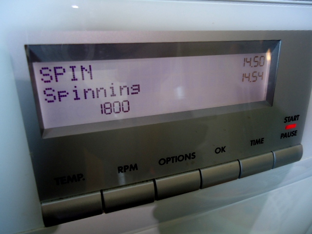

Post# 525719 , Reply# 8   6/20/2011 at 05:27 (4,691 days old) by chestermikeuk (Rainhill *Home of the RailwayTrials* Merseyside,UK)   |   | |
1600rpm and a large 8kg 60ltr drum for my needs, which when it comes down to it its what you find beneficial to your own needs & requirements, with the weather here and the need for tumble drying it gives me best performance..
We did a test at Johns house and a load of jeans out of the Hoover 9kg vision, 1600rpm, where spun at 1800rpm in the AEG and you could feel the difference and the time in the dryer was 15mins less... |

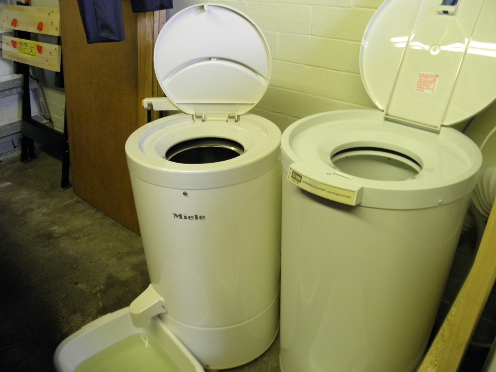

Post# 526189 , Reply# 11   6/22/2011 at 07:12 (4,689 days old) by paulinroyton (B)   |   | |
I have 2 sepearte spin dryers which spin at 2800rpm, clothes dry much quicker when you want to dry them in a tumble dryer. You don,t have to buy them new, just look on ebay as many bargains on there.
Paul |

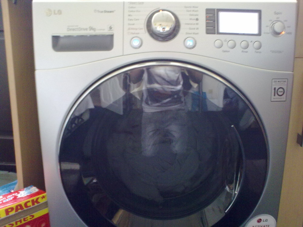

Spin speeds are always taken into account when buying a new washing machine, with atleast one wash per day in our household we need a fast spinning washing machine, and max spin is used pretty much all the time. Having bought the LG steam F1479FDS5 which has a max spin of 1400 which is very effective and clothes feel very well spun, especially on towels and jeans etc.
Btw- Although gorenje had a 2000rpm machine the residual moisture in clothes was 41% and hotpoint 1600rpm machines have 38%, which is the best i've heard of and seen so far in terms of technical data in residual moisture. Don't think i'll miss the 1800 or 2000rpm spinning machines from the market, don't think they do the machine any good and don't think they make a that bigger difference. |
