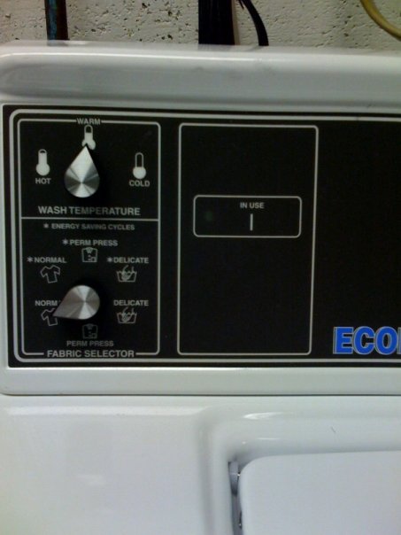

Sounds like the machine doesn't do a proper deep rinse with a full tub of fresh water, instead to make it more water efficient it pumps half the sudsy water out and tops up with fresh water doing a dilution wash. I would not add softener to this as you are mixing detergent and softener together, as for adding bleach I don't think a spray rinse before the final spin is sufficient to rinse the clothes properly.
With the importance of energy and water efficiency, top loaders don't work as well when you try to make them use less. Unlike front loaders they can still obtain excellent results using less water and energy, can rinse more times and still use less water than a top loader. |
Post# 525745 , Reply# 2   6/20/2011 at 08:03 (4,691 days old) by yogitunes (New Jersey)   |   | |
it's been nicknamed the "Gray Water Rinse".....which I really don't see a benefit....if it takes four minutes to fill for a normal wash, drain half and refill, thats two minutes, and then drain completely and spin, spraying water on the load for another two to four minutes before the faster final spin...just seems like it would use more water than a regular full fill wash and rinse......not sure on the exact specs...but this is what the contract/installers are complaining about....and their recommendations is they would not wash their own clothes in one of these...something to think about...

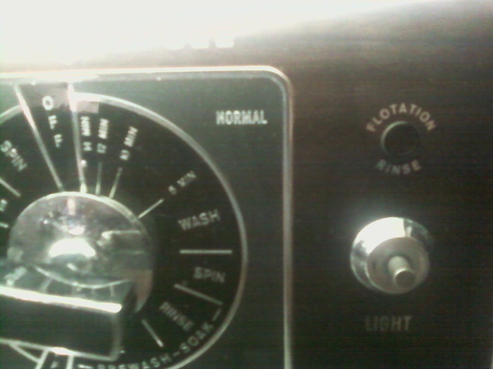

Flotation rinse light lit up anytime the washer SQ solid tub washer with that light would light up during the last minute or so of the wash cycle where the washer added water to overflow the washtub. This is how it got rid of lint and lighter than water soil. Then there was a pause and then the motor would reverse and spin the water up and over the top of the tub. Sediment was under the agitator and ejected out the tube. In the solid tub SQ washer I had growing up the tube was clogged. Never worked right and there was a sediment layer at the bottom of the tub. If we went to the beach then the sand stayed...had to vacuum that out more times than I care to admit.
The flotation rinse was also in the final rinse where it would fill while agitating the load for a couple of minutes. Overall my experience with a SQ solid tub washer was the the first one lasted almost 10 years and the 2nd one 6 years. Keep in mind I did laundry for 7 people and the machine was running everyday. Washed well and rinsing was awesome. Spin dry was another story. The top of the load was well spun...the bottom not so much. The washer capacity was the "extra capacity" tub but when my parents bought the Maytag A510 to replace the SQ washer what a difference in capacity. The Maytag was huge! |
