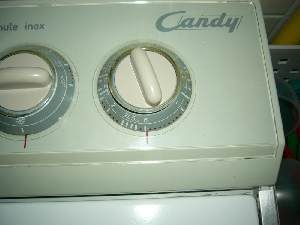

Mums Candy ACtiva AC101 had a triangle on the dial between the 40 cottons symbol and the Rinse shower symbol. The activa washing jet used to come on while wash water circulated through the dispenser drawer to flush out the bleach in the last 15 mins of the cycle or so.

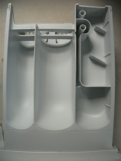

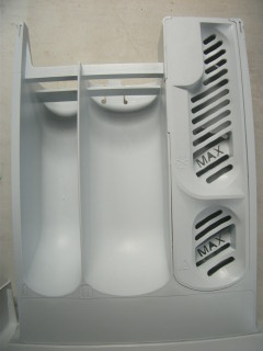

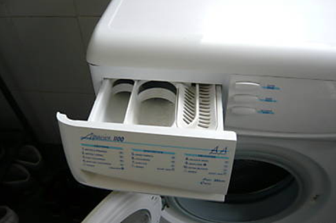

Are you sure isn't there something missing in your Hoover Performa's detergent drawer? My parents' old Zerowatt (Candy) had the same kind of thing, the compartment for the conditioner and the 1 for the bleach share the same section but there are two extra little compartments underneath which keep these 2 separate... so, unless you've taken the drawer apart, you might be deceived into thinking that they share the same container. On this machine the bleach compartment gets flushed out on the 1st rinse on cotton cycles only, on synthetic cycles this compartment can be used if 1 wishes to put extra fabric conditioner as it gets flushed out on the softner rinse together with its next door compartment.

On Candy machines ('80 & '90) or those that has the triangle the bleach is dispensed at the 2nd rinse. And I will tell you also why. If you are not using an entire cycle but only the "bleaching" one - setting the programe on the "triangle", the machine perform first a rinse to wet all the clothes and than on the 2nd rinse it flushes the bleach, because if the bleach will come in on dry clothes it may damage or cause spotting on the clothes itself. Ingemar |

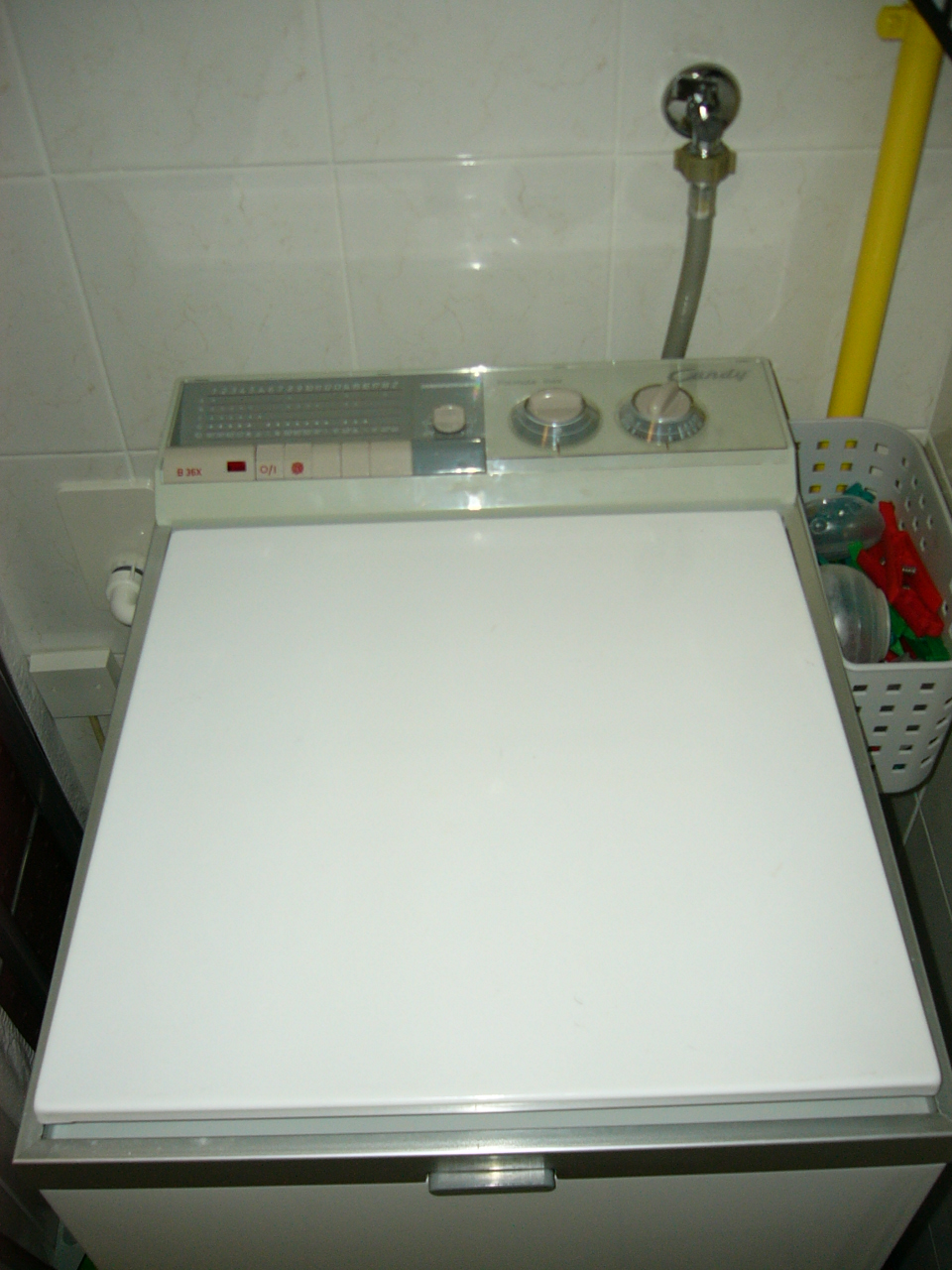

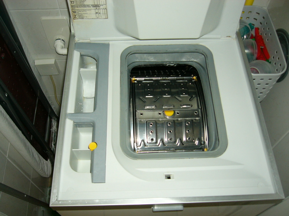

Now I am using an old Candy from 1988. In this washer (and in all similar Candy washers) you can use the bleaching in two ways. 1) as an indipendent bleaching alone cycle - setting the programe on the "triangle". The machine will first fill water but NO bleach to wet the clothes, than drain and than when it steps to the rinse cycle (with the symbol of the "shower"), on programme 6 it flushes the bleach and performs the entire rinsing cycle as normal. 2) as part of the white wash - the washer performs the wash cycle normaly, than when it comes to the "triangle" nothing happens since the clothes are already wet, and than when the first rinse begins, on programme 6 it flushes the bleach and steps toward finishing the rinse cycle as normal. Yes now the modern washers has no longer the bleaching option because most (quite nobody) people here don't use the chlorine bleach in the washer. As Dex has said when needed we use the All-Fabric Bleach (non-chlorine) in the wash cycle. Ingemar |
