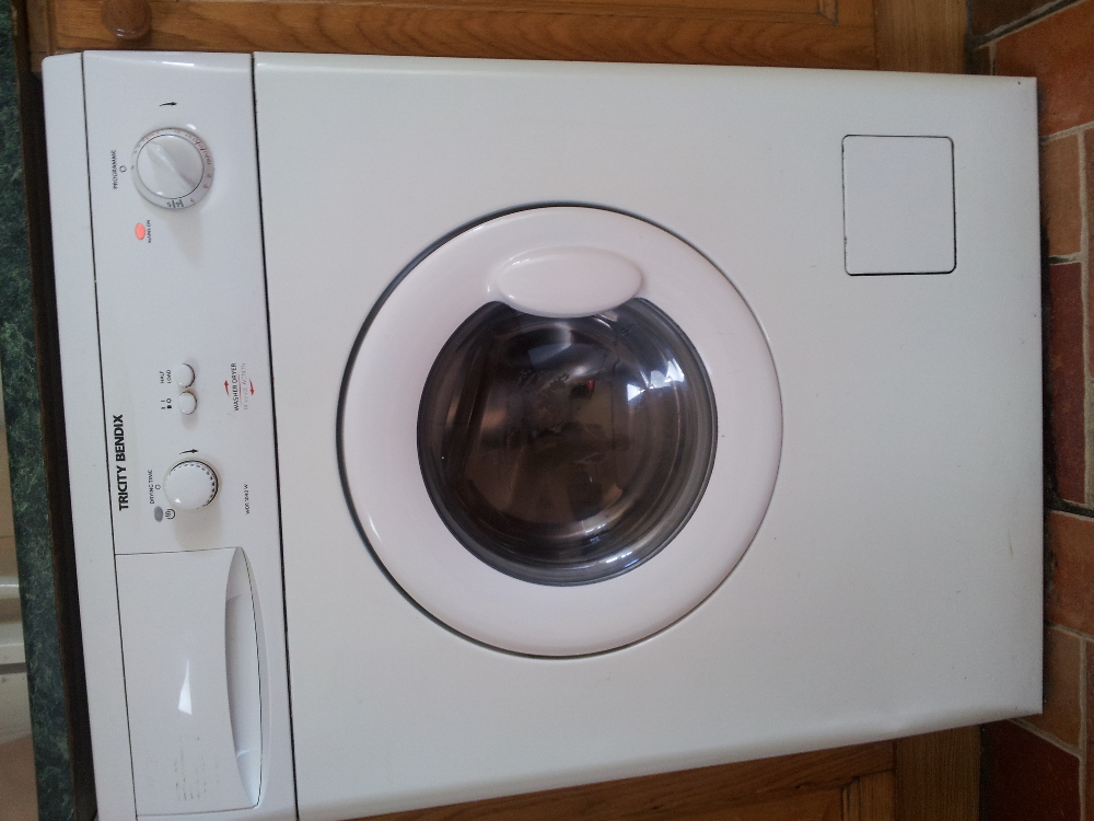

need help quick |
Post# 535328   8/6/2011 at 10:20 (4,640 days old) by ariston4life ((Dublin) Ireland)   |   | |
Post# 535329 , Reply# 1   8/6/2011 at 10:29 (4,640 days old) by washerlover24 ()   |   | |
Its the module I had a servis washer dryer and it did the same thing its about and £75 fix we just a new machine becasue it was old anyway Hope this helps Trey |

hey luke hope alls well....its the timer/module there the one piece behind the timer dial....common fault...looking at that model id say its out of its 5 year parts... |

If the machine is distributing but not going into a full spin and then ending the cycle as normal, it could quite possibly be the filter. Zanussi's are a bugger for it. My Mums Bendix does this and, as already stated, my Dad's did. Just try draining the pump and washing the filter out and see if it works. You might be surprised.
