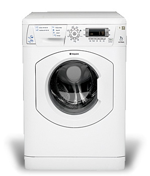

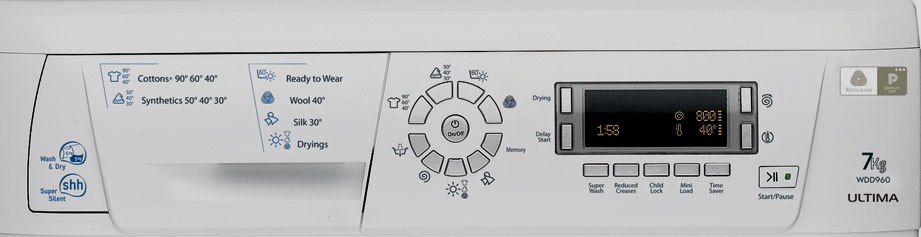

I`l never get used to these new patterns of drying, am babysitting so using the Ultima WDD960 - 1600rpm washer dryer...
Cottons 3kg - High Heat 10 mins tumble 2 mins distribution 10 mins tumble 2 mins distribution 10 mins tumble 10 mins SPINNING UP TO 1600rpm - how weird is that!! 2 mins distribution & pumpout now tumbling intermittent fast / slow Nearly Dry!!! and Super Silent....Yay!! |
Post# 542435 , Reply# 1   9/8/2011 at 15:51 (4,607 days old) by marthalover4eve ()   |   | |
its called a thermal spin its to get creases out of clothes |
Post# 542438 , Reply# 2   9/8/2011 at 15:56 (4,607 days old) by aquarius1984 (Planet earth)   |   | |
Thermal Spin to get creases out?
More like set them in, However only if you were to stop the machine directly after. The theory behind the Thermal spin is that the fabrics are more relaxed when hot and steamy so the fast spin helps to release more water to cut down on tumble drying times. Everything creases but the heat and residual time of drying after smootehs it all out again to an acceptable level. Once lived in a houseshare that had an Indesit WasherDryer 1200 and was always impressed at the drying times it offered although its small by todays standards 5kg tub made a fair mess of jeans and heavy items even with a much reduced load. Id love to see how these larger capacity machines do with such loads. |
Post# 542441 , Reply# 3   9/8/2011 at 16:25 (4,607 days old) by chestermikeuk (Rainhill *Home of the RailwayTrials* Merseyside,UK)   |   | |
Well ya learn nu stuff everyday!!! LOL.....although the Thermal Spin is used to move the moisture out of the clothes quicker than normal drying, not only to take out the creases...
This isnt a new technique though it was used in washer extractors in russian laundries in the 60`s - pressurized steam was used to aid drying!! Well my drying is done and not a crease in sight and it had really cooled the load down unlike the Fagor washer dryers which leave the load very hot at end of cycle |
Post# 542443 , Reply# 4   9/8/2011 at 16:27 (4,607 days old) by Haxisfan (Europe - UK / Italy)   |   | |
I'm more inclined to think that a similar behaviour would set stubborn creases in your clothes... come on chestermikeuk... you tried it... you must know... does it really crinkle your clothes to death? How does it compare to other washer-dryers you used previously?
The Indesit washer-dryer I used on holiday was wrinkling my stuff like there's no tomorrow... but I don't think it was doing a thermal spin which I can only assume (in a weird but logical way of thinking) that would make matters worse. Well, let me know... I'm really curious ;-) |
Post# 542586 , Reply# 5   9/9/2011 at 13:26 (4,606 days old) by chestermikeuk (Rainhill *Home of the RailwayTrials* Merseyside,UK)   |   | |
Put a 3kg load in and set auto dry, high heat, cupboard dry sensor setting - the timer started to read 140mins, then it went through the routine and I timed it...it completed the dry load in just over 60 mins...all dry, no creasing and clothes and tub where cooled down which doesnt happen in the Fagor, & Zanussis have used ...
Must admit am very impressed, its very quiet in action and it completed the job to great satisfaction....I`ll plug my leccy meter in next time to see how many units it used... Cheers, Mike |
