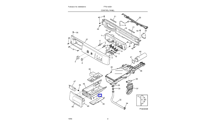

Post# 547755 , Reply# 7   10/6/2011 at 10:31 (4,578 days old) by PassatDoc (Orange County, California)   |   | |

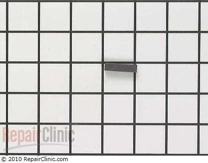

I called Repair Clinic. Since I have an account there, I logged on to the Help section and explained the problem: magnet fell out, I don't know how/where to reinsert. Supposedly they return e-mails within 48 hours. We'll see. I asked them for a parts breakdown diagram so hopefully I can figure out how to reinsert. |

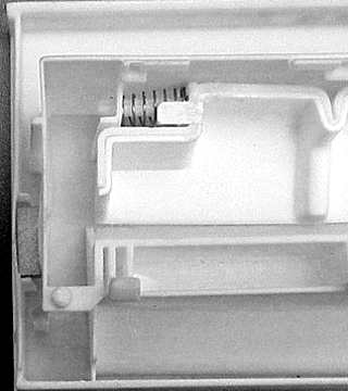

Post# 547780 , Reply# 9   10/6/2011 at 12:25 (4,578 days old) by steved (Guilderland, New York)   |   | |
I believe this is the underside of the drawer. See the magnet half way down on the left edge? |
Post# 547799 , Reply# 11   10/6/2011 at 13:26 (4,578 days old) by PassatDoc (Orange County, California)   |   | |
It looks as if the bottom panel (part 50) snaps off and then the magnet (part 51) goes on the right side or something. The diagram is very small (I did not shrink it to size) and hard to read, but they did circle part 51 (magnet) in blue. |

Post# 547895 , Reply# 16   10/6/2011 at 23:14 (4,577 days old) by nurdlinger (Tucson AZ)   |   | |
I located the magnet in the tray on my KM twin to the BigSquareDoor model Frigidaires. It's tucked inside the front of the drawer (part #48 in the drawing) along the right vertical edge as you look from the front of the tray. (The same side as the number 49 is found on your diagram. The side closest to the dial.) But it's about halfway up the vertical side, against the flat side closest to the dial. There is a little plastic tab which holds it in place, perhaps that tab broke and let your magnet fall out. The picture posted by SteveD is similar but not the same. The location is the same, but the tab to hold in the magnet runs along the long side, instead of two tabs on the ends as in the photo.
I have the Electrolux parts diagram PDF, it's somewhat bigger than the one from the parts place. It is also misleading, in that it seems to show that the magnet fits sideways along part #51, when actually it is #48 as I mentioned above. I can E-mail if you wish, or you can fetch it yourself, the filename is 5995430336.pdf. I'm blanking on the URL for the site, however. I can take some pictures if you wish, but I'm sleepy right now and so I won't do that unless asked. If the tab is gone, I thinkt the idea of holding it in place with silicone sealant would work. Good luck |
Post# 547959 , Reply# 18   10/7/2011 at 09:19 (4,577 days old) by golittlesport (California)   |   | |
