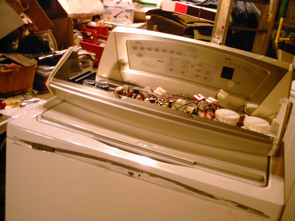

I've not had any trouble with the Calypso I refurbished 4 years ago, have been using it as my daily driver for past three years. It's running the original pump far as I know. I have two spare pumps, a motor, water valve assembly, a full control panel, and two more sets of boards, need to get hold of a u-joint and leveler and maybe a basket so that I have all the major items covered. I have another Calypso stashed in my garage. |

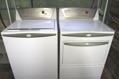

you mean like this....of course it is a whole set...and the price is a bit steep.....but anything can be negotiated!....or keep searching...
