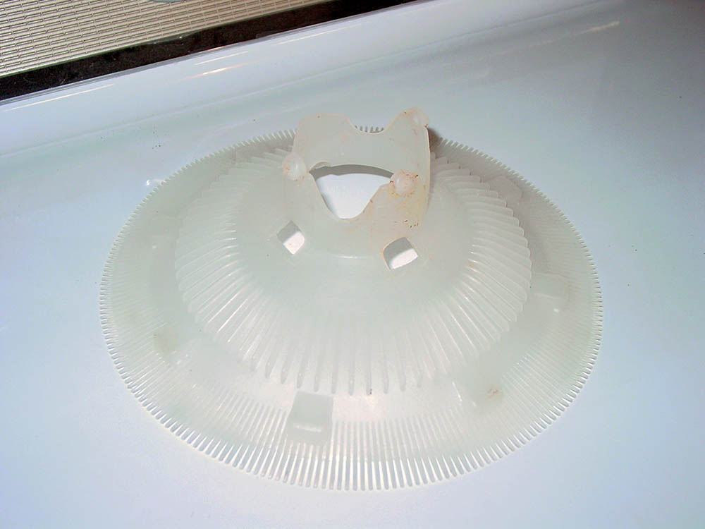

This filter debuted with Kenmores in 1982. By this time, the slight capacity reduction (baseplate redesign) had already taken place and machines had been manufactured for close to a year with the old type filters.
When the disc came out, the baskets had to be altered to have the holes underneath the agitator to allow the currents and lint to be flushed onto the disc., AND agitators had to be updated as well to have little vanes on the underside of the skit to create these currents. In fact, there are two differences between the gold Kenmore Penta-Vane and the white - one is the inclusion of these mini-fins in the white version. Many people don't realize that this disc filter will be largely ineffective if a previous agitator is used in disc filter model. |

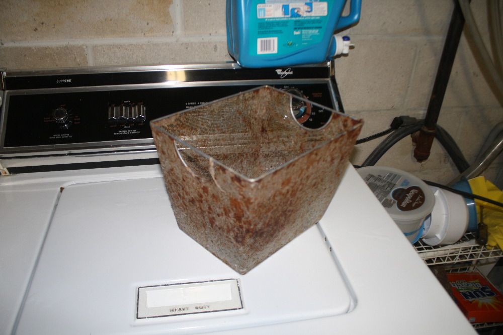

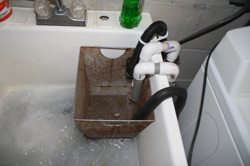

For you guys who catch the lint in the sink with those little screens that fill up quickly.......stop wasting your money......
I got this at FiveBelow...for 5.00....this one is about 3 years old, and time for a new one......but once it gets filled, I take it out back and backflush it with the hose.....and it gets used over and over!..... |

YogiTunes! I think that is ingenious! I have one of those "file baskets". I think I am going to go try filing some lint! :) |
