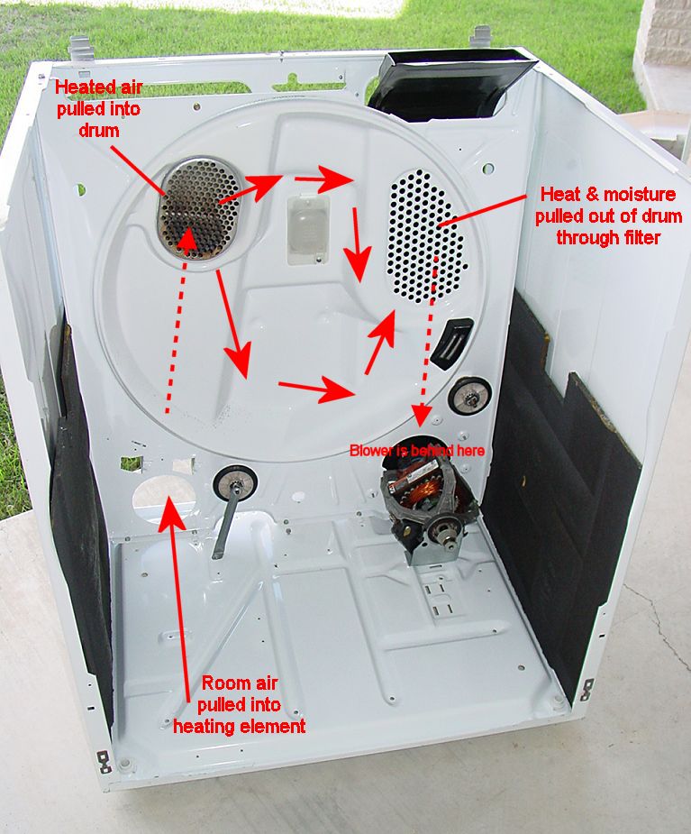

Running a 220V electric Whirlpool dryer (27 inch machine to be exact) that runs entirely on a computer on 110V... I've done it with a mid to late 90s Kenmore dryer (pic below) but, it seems to have trouble calculating the estimated time remaining. It generally shuts off too soon. I've tried running it on high heat, extra low heat, heavy duty, delicate, etc. And I can't seem to find a way to make it run through a cycle and dry everything all the way the first time around. If I run the same cycle 2-3 times, it can dry everything.
My question is, has anything changed in dryers between then and now in terms of calculating when the clothes are dry? If I bought a new electric dryer and ran it on 110V, would it run into the same problem? I am planning to have both a washer and dryer next year in my apartment but there is no gas or 220V power available. I'd still like the capacity of a full size machine, I don't mind the longer drying times. |

when you run a 220 dryer on 110 it never gets hot enough to get into the paramater of the controles weither humidity sensor, short out wires, or temp time circut. better off just using old fashond time cycle. sorry ! |

Jamie all you need is a 27" dryer with a sensor strip on the lint filter housing that has a mechanical timer and no thermistor. I wish you were closer I would give you one today they are very common. This dryer will run until the clothes are dry, you can even disconnect the heater and let things dry with air alone and it will not stop until they are dry.
I am sure you know that when you go from 240 volts to 120 volts the heater only produces 1/4 the heat that is produced on 240 volts. Yet in spite of this it usually only takes three times as long to dry not four times. This is because that more of the drying is being accomplished with the ambient air temperature, so the end result is getting the job done with about 15% less total electricity consumed than drying the load on 240 volts.

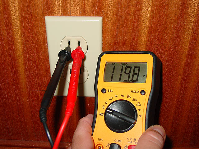

Post# 557146 , Reply# 17   11/16/2011 at 23:45 (4,541 days old) by supremewhirlpol ()   |   | |
Be very careful about what you ask for John(combo52). Those voltage readings are VERY possible in my house. |

Post# 557152 , Reply# 19   11/17/2011 at 00:10 (4,541 days old) by Launderess (Quiet Please, There´s a Lady on Stage)   |   | |
Well domestic versions no, but IIRC most if not all commercial appliances have 220v (or whatever) motors. Wascomat and some other brands do have 110v motors in a narrow "homestyle" range of products but those are intended for semi-commercial use such as in a beauty salon or say a small nursing home that does not have heavy usage requirements.
Seem to recall somewhere that 220v/240v powered motors are more robust than their 110v/120v cousins. |
Post# 557175 , Reply# 20   11/17/2011 at 06:06 (4,541 days old) by akronman (Akron/Cleveland Ohio)   |   | |
As the country was being quickly wired in the early 1900's, a trade association of electricity producers and distibutors decided on their goal: Absolute max of 125/250V if you lived right next door to an electric plant, and an absolute minimum of 110/230 if you were way out of town, on a farm or something at the very farthest limits of the distribution network. This was further written in stone in the 30's with the TVA and REA. In my home, it fluctuates from 116.6 to 117.8 at different times I've been doing a wiring project. |
