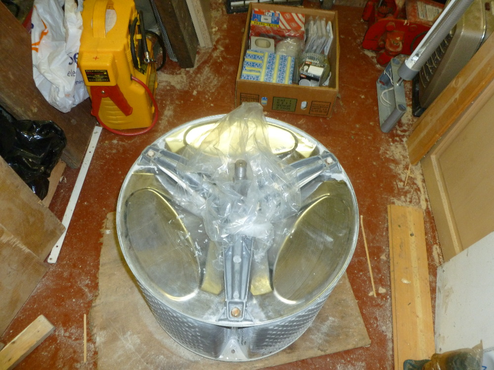

The programmes. The bearings are dead. |

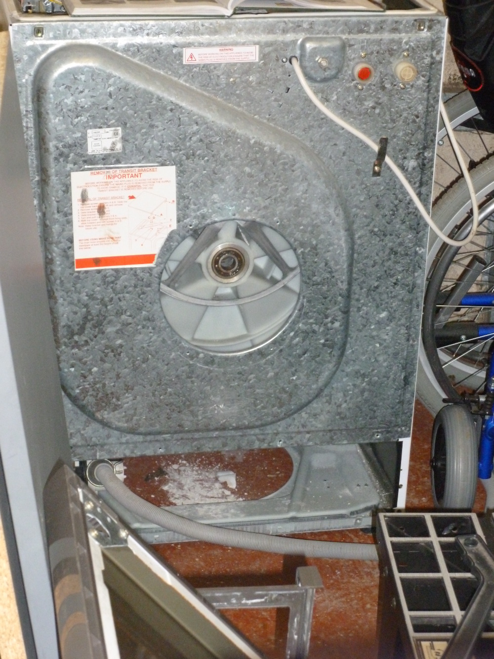

Post# 563033 , Reply# 10   12/13/2011 at 15:55 (4,516 days old) by supermaticjames (Donegal, Ireland)   |   | |
Probably a cracked spider. A spider and bearing kit is usually £20. James. |
Post# 563138 , Reply# 11   12/14/2011 at 03:06 (4,515 days old) by aquarius8000 ()   |   | |
Hi James. The machine sits in the garage and I removed the back panel and evreything was intaced. Hopefully it will only be a new spider kit, not a drum! |

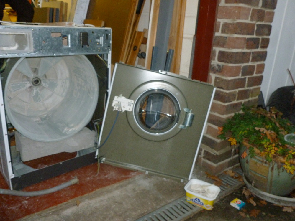

Post# 563497 , Reply# 13   12/16/2011 at 03:46 (4,513 days old) by aquarius8000 ()   |   | |
Update, I have taken the whole front of the machine off including the seal with out bookss or videos. |
Post# 563713 , Reply# 15   12/17/2011 at 11:54 (4,512 days old) by aquarius8000 ()   |   | |
Progress- We removed the tub and the spider is broken. |

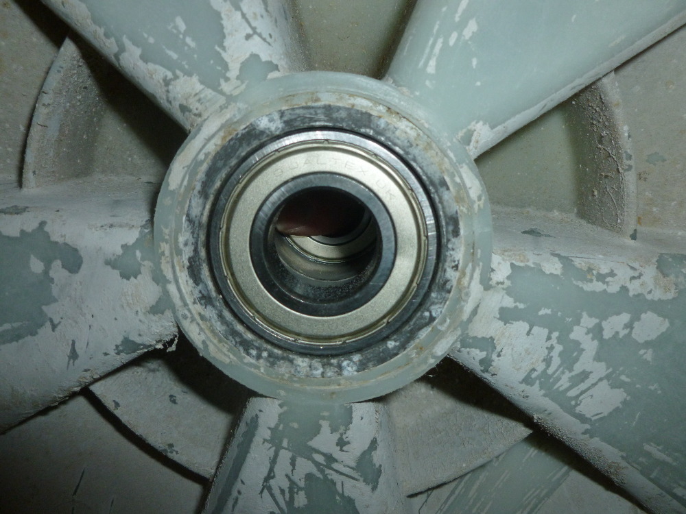

Bearing seal out and bearings to do. Pump + hoses all cleared. |

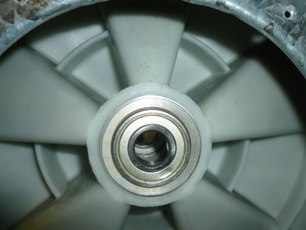

Post# 565400 , Reply# 20   12/27/2011 at 12:18 (4,502 days old) by aquarius8000 ()   |   | |
So I have removed the bearings and fitted the small one and the large bearing 3/4 of the way. The spider is now attached to the drum and will be tested tommorow. Pictures to follow. |
Post# 565401 , Reply# 21   12/27/2011 at 12:23 (4,502 days old) by aquarius8000 ()   |   | |
Sitting there in the garage. |
Post# 565403 , Reply# 22   12/27/2011 at 12:35 (4,502 days old) by aquarius8000 ()   |   | |
Intageral parts |

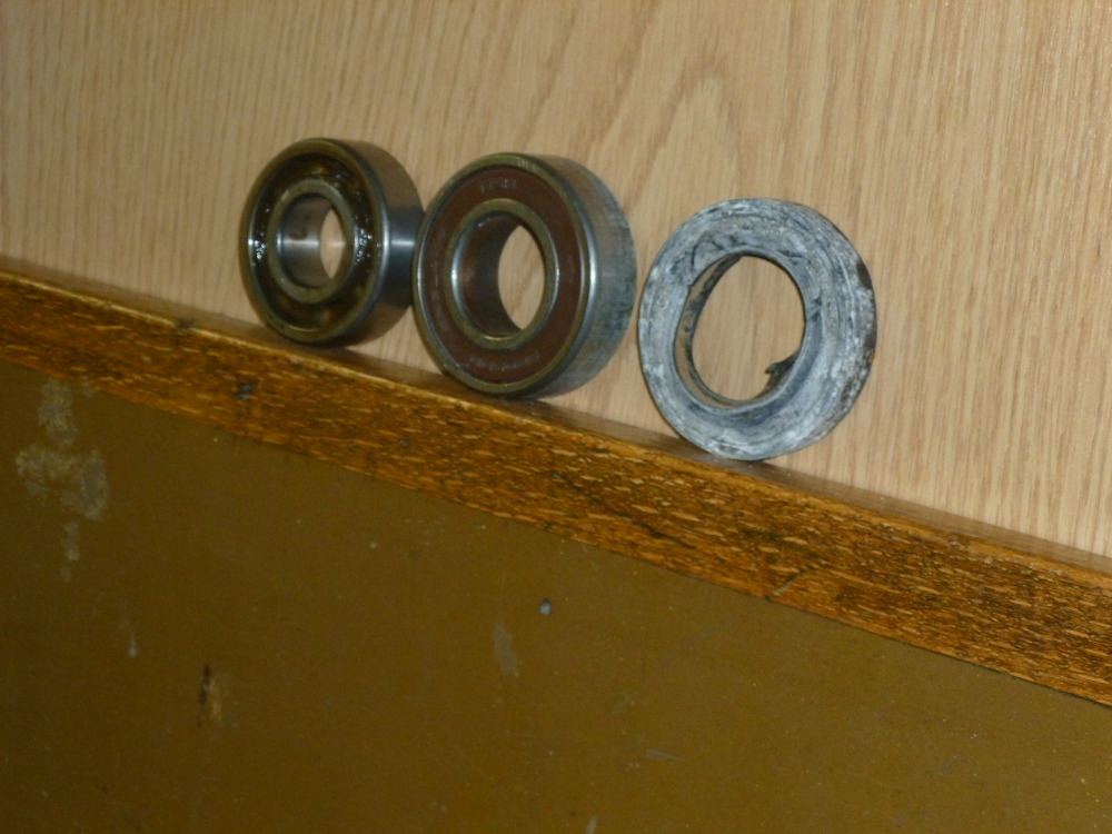

Post# 565404 , Reply# 23   12/27/2011 at 12:39 (4,502 days old) by aquarius8000 ()   |   | |
the old bearings. They were ok but we replaced them. |
Post# 565405 , Reply# 24   12/27/2011 at 12:48 (4,502 days old) by aquarius8000 ()   |   | |
New rear bearing applied |
Post# 565406 , Reply# 25   12/27/2011 at 12:49 (4,502 days old) by aquarius8000 ()   |   | |
large bearing allmost in. |
Post# 565408 , Reply# 26   12/27/2011 at 12:57 (4,502 days old) by aquarius8000 ()   |   | |
Spider attached to drum |
Post# 565413 , Reply# 27   12/27/2011 at 13:21 (4,502 days old) by ozzie908 (Lincoln UK)   |   | |
I found the easiest way to ensure the inner bearing was in and seated correctly was to use the old bearing on top of the new one and hammer them in you just remove the old one out the way. It helped to make sure you get it in straight and then use a little vaseline around the black seal to get it to go in easier. Boy it takes me back seeing the insides of that washer I had many a one of those in bits in my old shed :)
Keep up the good work. Austin |
Post# 565418 , Reply# 28   12/27/2011 at 14:07 (4,502 days old) by aquarius8000 ()   |   | |
Hi Austin. We carved some wood on a lathe and tapped it in. the small bearing went in no hassle at all. |
Post# 565560 , Reply# 29   12/28/2011 at 11:51 (4,501 days old) by aquarius8000 ()   |   | |
Well it now works! Pictures soon! CLICK HERE TO GO TO aquarius8000's LINK |

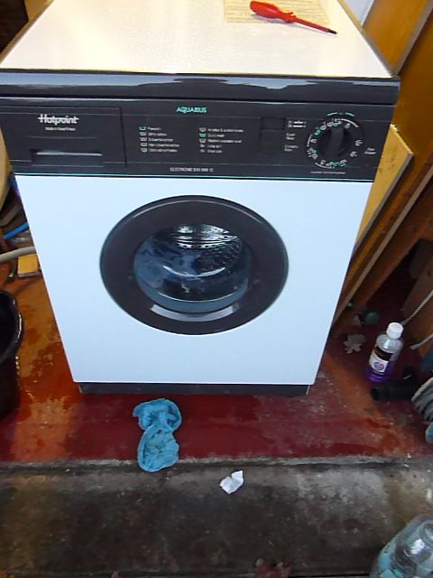

Post# 566406 , Reply# 40   1/2/2012 at 04:29 (4,496 days old) by aquarius8000 ()   |   | |
Hi. My camerea & pc are giving me mouse eggs now and so i cant post the pics. Also I had a wd61 but the motor died:P |

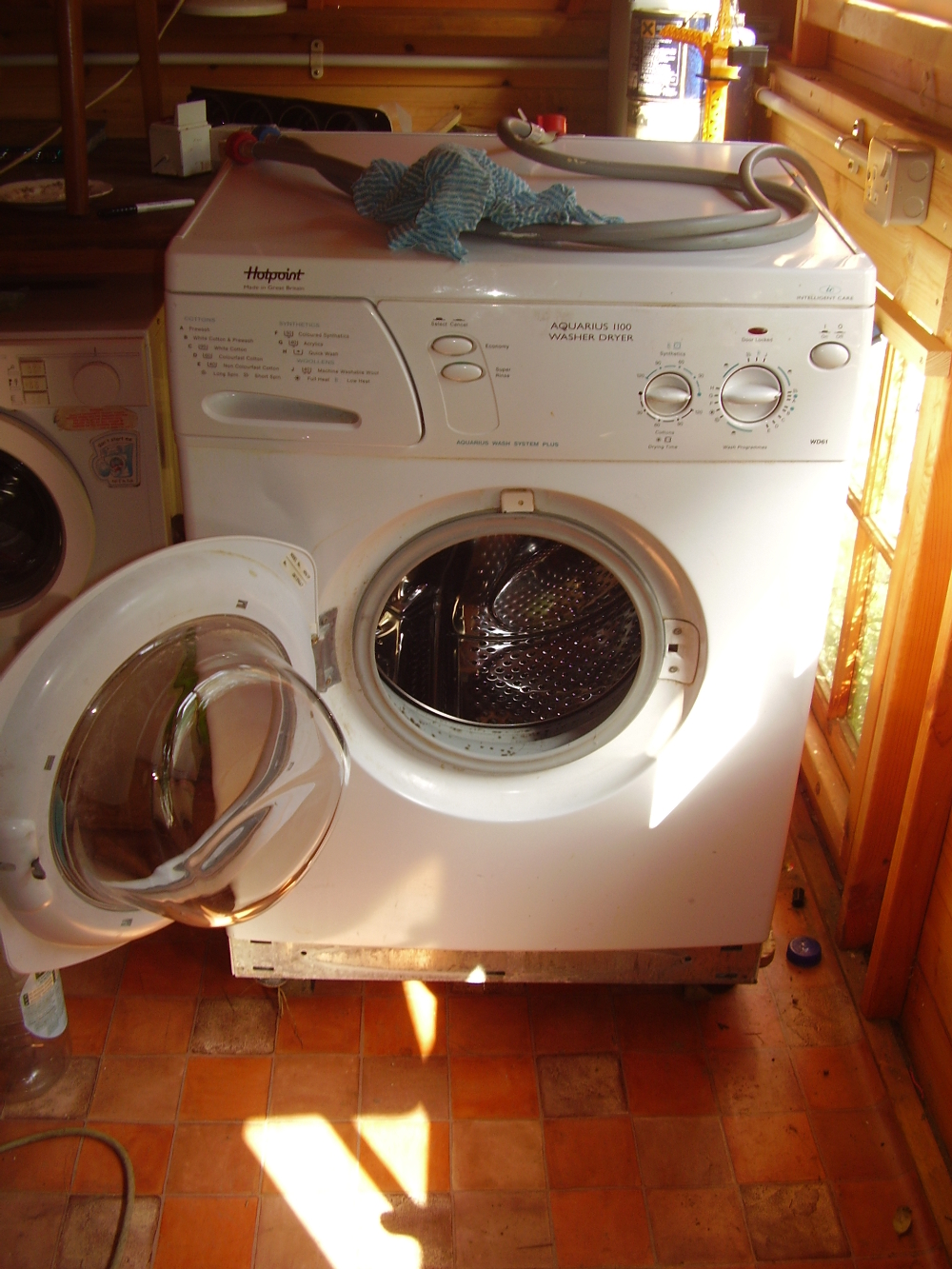

Post# 566423 , Reply# 41   1/2/2012 at 08:15 (4,496 days old) by aquarius8000 ()   |   | |

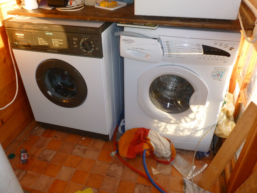

Ok its in the shed and doing a wash! |
Post# 566452 , Reply# 42   1/2/2012 at 10:33 (4,496 days old) by aquarius8000 ()   |   | |
Installed in her new home! |
