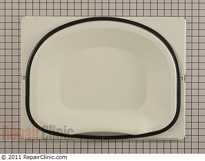

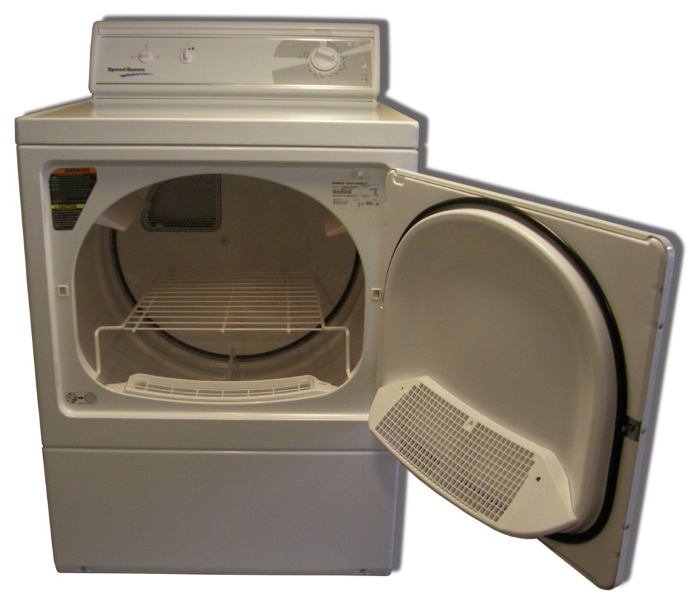

Oh okay got it, thanks.
Wished the one I'm buying came with the grating too, I used a GE profile dryer that had this kind of fixed in filter and found it much easier to clean, my other whirlpool dryer (wich is still working fine, just wanted a gas dryer) have a lift out screen, when drying wool it gets very full with very puffy woolen lints and I've to be careful when lifting it out as some wool would drop into the fan...but maybe Speed Queen designed it better. Anyway I'm so happy for it as I've been finally able to get a gas dryer for a very very cheap price! |
Post# 564963 , Reply# 6   12/24/2011 at 01:06 (4,499 days old) by laundromat (Hilo, Hawaii)   |   | |
Me thinks that the first dryer is the same model or design as the SQ commercial ones. If you look closer at both filters, one is screwed in to stay put (some SQ laundromats are open 24/7 with little management to save money and make a profit) so nobody can steal it too easily.The second one has a removeable screan that could easily be either stolen or used as a toy or weapon.Some dorms and/or bed and breakfast places that have the models made for such places have this exact model that is not coin operated. I had the stacked models that had the same set up but were far from true commercial machines.The top loading washers were problemaqtic and the dryers were not that large in capacity. It would take a king size bedspread but you had to put four times the money in to make sure it was going to be thoroughly dry. You also have to stop the machine every 30 minutes to reverse the billowed up,tangled bedspread.Otherwise, it would stay wet in the center.
