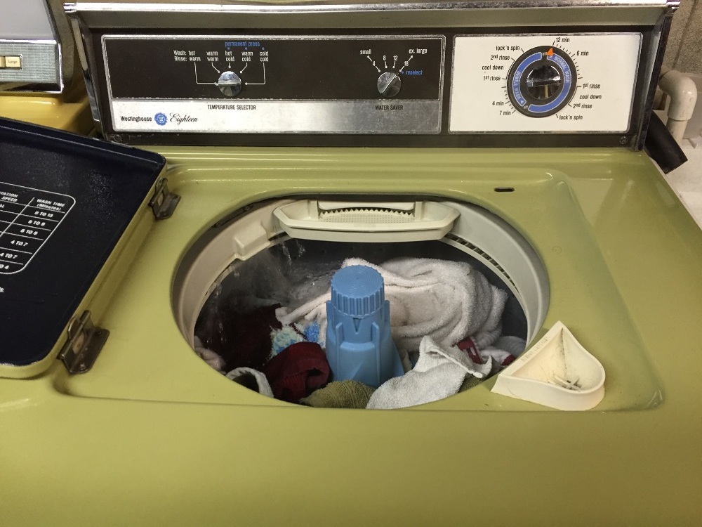

Post# 1060685 , Reply# 27   2/15/2020 at 21:02 (1,136 days old) by Yogitunes (New Jersey)
yogitunes's profile picture
Reply #17....
the two agitators shown are actually the Handwash(on the left) and Regular(on the right that slides over top)....

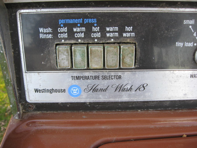

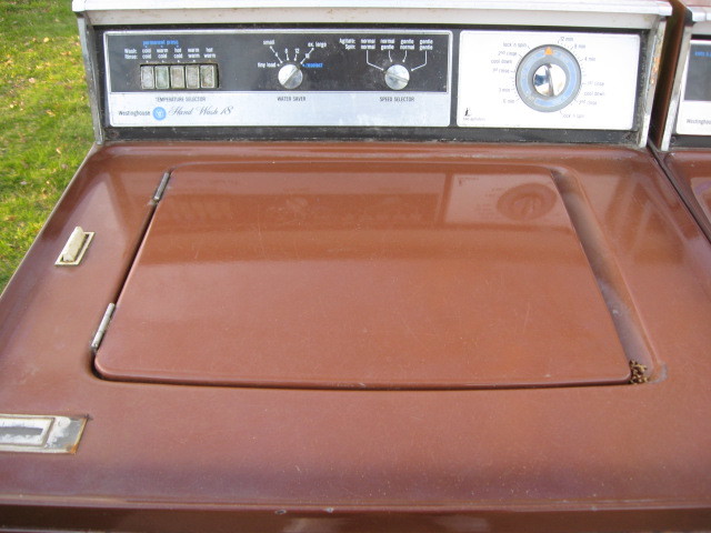

Post# 1060714 , Reply# 28   2/16/2020 at 11:35 (1,135 days old) by pierreandreply4 (St-Bruno de montarville (province of quebec) canada)
question about westinghouse washer dryers
what is the diffrence between the push button model for wash rinse temp and knob that you turn and what model was it that offered the blue agitator and did it come withe the liquid fabric softner dispenser and whats the advantage of the wash spin speed selector thats on certain model like i said its very longterm planing of course it would have to be harvest gold but find the westingouse washer dryer simple in term of use?
Post# 1060718 , Reply# 29   2/16/2020 at 13:37 (1,135 days old) by DADoES (TX, U.S. of A.)
dadoes's profile picture
Temperature selection.  One is buttons, one is a knob.  No other difference.  Both offer the same five choices.
Speed selection.  The machine with separate speed selector allows using any speed with any cycle (longer "Normal" Wash/Soak cycle and shorter Knit Fabrics cycle).  Also provides multiple combinations of agitate and spin, such as Low agitate and High spin for woolens or High agitate and Low spin for permanent press items.
The machine without a speed selector has the speed set into the timer cycles.  Normal Wash cycle is High agitate and High spin.  Gentle Wash cycle is Low agitate and Low spin ... no other choices.

Post# 1060736 , Reply# 31   2/16/2020 at 16:32 (1,135 days old) by Yogitunes (New Jersey)
not sure about all machines....but noticed back then, push button controls cost a bit more than rotary controls...
not a substantial amount, like around 25.00....but as you compared models, the only difference was price and controls used....
