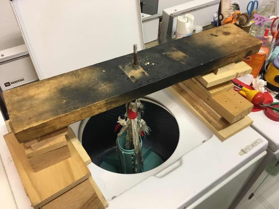

Alright I have another Maytag that won't agitate, but it spins. Repair Guy said it was the belts which I replaced but still won't agitate. How do I remove the agitator? I feel something down in there but I can't get a socket driver to get hold of it.
CLICK HERE TO GO TO jacnorectangle's LINK
Post# 1188682 , Reply# 17   8/27/2023 at 21:48 (599 days old) by stuftrock1 (Kentucky)
Reply 16
stuftrock1's profile picture
just loosen the hex head screw on the side and the agitator should pull right out. I don't remember the size of the screw off the top of my head, I think maybe 3/16"? If not then 1/4".
I don't understand how a bad belt will allow a spin but not an agitate. What exactly happens when it tries to agitate?

Post# 1188813 , Reply# 20   8/29/2023 at 11:12 (597 days old) by combo52 (50 Year Repair Tech Beltsville,Md)
Removing a Maytag Agitator
combo52's profile picture
It’s either a quarter inch head screw or a torx screw.
The one that won’t agitate probably has it locked up transmission, take the motor off that one and put it on the other machine.
The first machine is a 1982 machine so it’s got some age on it so you may have to do some fairly serious repairs on it,
John
