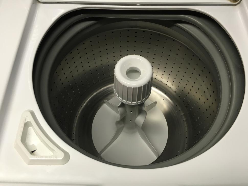

Post# 1190566 , Reply# 14   9/24/2023 at 15:37 (378 days old) by Good-Shepherd (New Jersey)
Looks decent, tub still has a nice gloss so it probably wasn't used with hard water.
I'd offer $100, you'd be getting a good deal, provided you pop off the front panel and it looks okay inside as well, (no evidence of leaks or rust).
Clean it up, lube the damper pads and put it into service.
