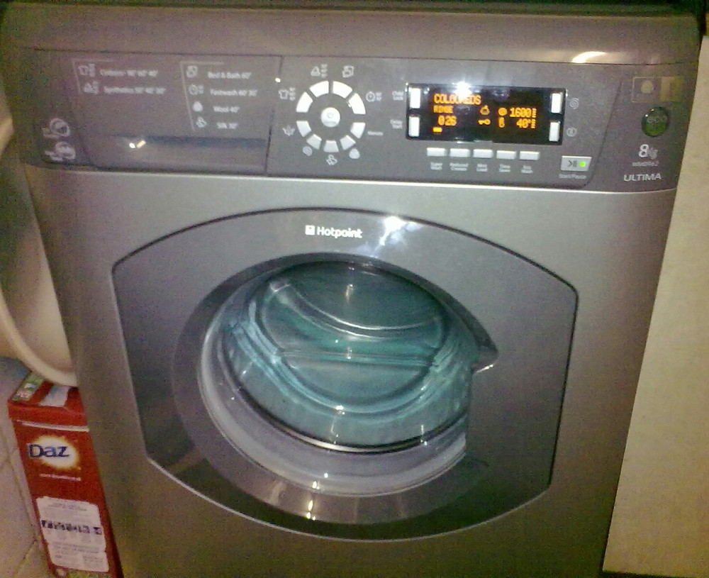

Hello all
Hope everyone's well :) Got a call from my cosin, her mums wt960 ultima "popped"! We changed te fuse 2 times, each time we turn the switch on it did that. Aunts not happy, it's only been 3 years since we got it. Can it be fixed for the time being as the bearings aren't that bad? If not she's already decided to opt for a hotpoint ultima wmd962g as she never buys any other make and wants it to match the new fridge/freezer and cooker etc. Thanks |

This could be due to lots of faults, one which can be common is the door interlock becomes faulty and the contacts touch the machine cabinet, maybe the heater has become faulty but this would normal allow the machine to start for a few minutes then blow the fuse. It’s hard to tie it down some times.
