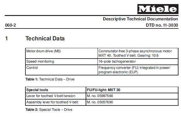

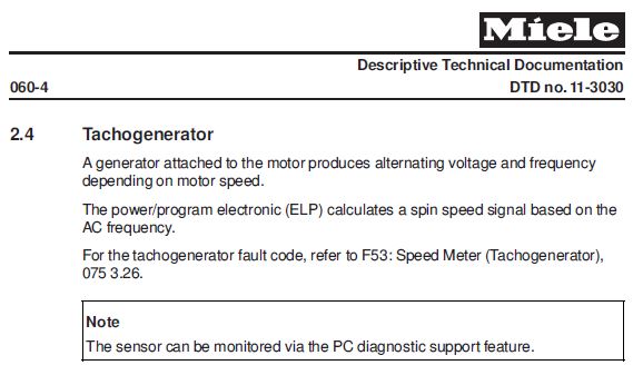

Fault code F-50 is:3.29 F 50 Drive
Symptom In the operating mode the display indicates: Technical fault. No drive. The program is stopped, the water intake valve is closed, and the drain pump is switched on for 120 seconds. Cause Defective motor, which in turn causes the fault “defective frequency converter”. Remedy A Check the motor, refer to Drum drive defective, 060 3.1. Cause Defective frequency converter (FU). Remedy A Replace the frequency converter (FU). Descriptive Technical Documentation DTD no. 11-4800 070-29 |
Post# 501256 , Reply# 20   3/4/2011 at 13:02 (4,802 days old) by jerrod6 (Southeastern Pennsylvania)   |   | |
Frequency converter. I am not very knowledgeable about electric. I wonder what is being converted? From what to what? |
Post# 501284 , Reply# 24   3/4/2011 at 14:31 (4,802 days old) by vacfanatic ()   |   | |
