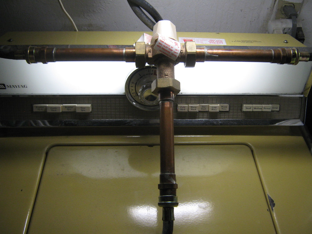

Post# 505124 , Reply# 3   3/19/2011 at 00:43 (4,787 days old) by qsd-dan (West)   |   | |
If anyone is interested, the link is the valve I found.
Here is an example of an adjustable valve (68F-130F) with no need for soldered connections.
Below is a pic of my adjustable valve (80F-140F) with soldered connections. |
Post# 505183 , Reply# 4   3/19/2011 at 11:29 (4,787 days old) by labboy (SD, CA)   |   | |
I really like the valve you posted in the eBay link. Your soldered in valve is also very nice. However, I'm dealing with more limited space and don't want to deal with exposed pipes or having to put pipes behind the wall.
I could do what I want with the valve you posted from eBay. I would only need two extra hoses and a Y bib for the hot faucet. My washer has ATC and quickly cycles the hot and cold when filling. How do you think the valve would hold up over time with the ATC associated cycling? |
