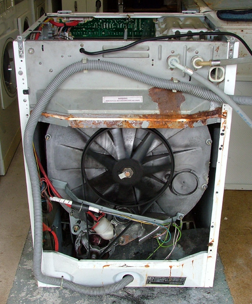

As some of you know I had a swan 9Kg steam washer and its dies after 5 months and 3 engineers visists couldnt fix it so opted for a hotpoint to tide me over. Had to take the back plate off this morning to undo the transit bolts and the spider is made of plastic (think its called a spider) big wheel at back of the drum with belt that connects to the motor. OMG how long this will last i dont know. I personally think they have gone too far now in a bid to save money on building them. Anyone else noticed this and sorry in advance for not takin a pic to show was that desperate for the machine to be used I forgot |

yeah as people have already clarified it usually is made of plastic, the pulley wheel. What model is the new hotpoint? i like hotpoint machines, many people would disagree but I have family and feiends whom mostly buy hotpoint, most have good luck with them. Many still going strong after many years of heavy use day in day out. Hope the new machine serves well |

The inner spider is required to be as strong as possible and plastic wouldn't satisfy such requirement. The whole wait of a full load of clothes + water is propped up by this together with the rest of the components that hold the bearings... whereas the pulley does not need to be so strong as it only transmits the power from one axis to another and it doesn't actually support anything.
That's why disaster strikes when the spider breaks... the inner drum must be severely constricted to run around its predesigned plane keeping equidistant from the plane occupied by the outer tub and for this to happen you need a real strong support: a front loader constantly fights against gravity. |
Post# 506845 , Reply# 13   3/25/2011 at 18:00 (4,780 days old) by 3beltwesty ()   |   | |
A plastic spider is possible; but one would have to make out of say polycarb that is glass filled. Then its cost would be higher than an aluminum casting. |
