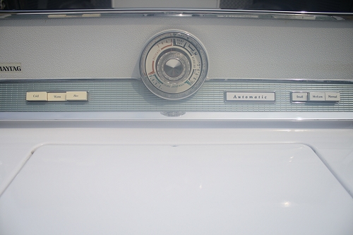

Regular Capacity, single speed, non-suds saver, 3 water levels. A great washer. Make sure to clean the lint trap in the center of the agitator. Just grab it and pull up. If it hasn't been cleaned in a long time, soak it in some hot water and scrub with an old toothbrush, pushing the bristles into the holes. It makes a difference in performance, believe me!
It may not be a bad idea to pull off the front and remove the small front-facing screw in the pump housing, add a few drops of Zoom Spout Turbine Oil, and replace the screw. Clean out the dryer and make sure there are no vent restrictions. Great set! Dave |
