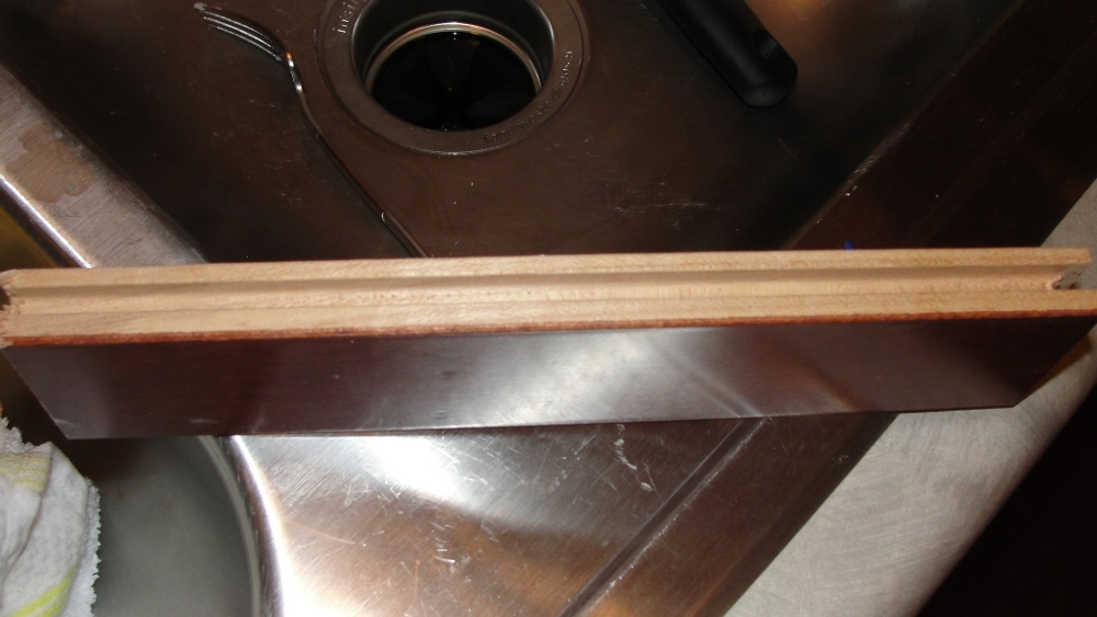

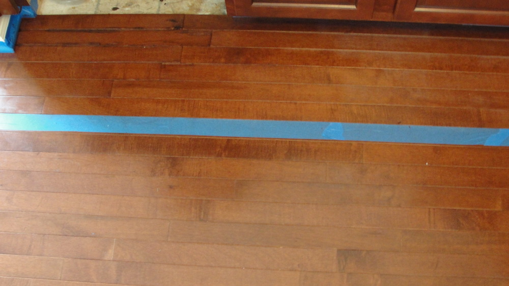

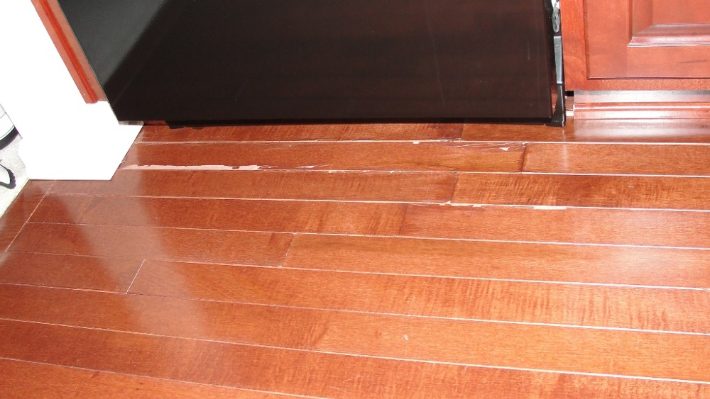

Post# 521216 , Reply# 1   5/29/2011 at 06:41 (4,715 days old) by vacfanatic ()   |   | |

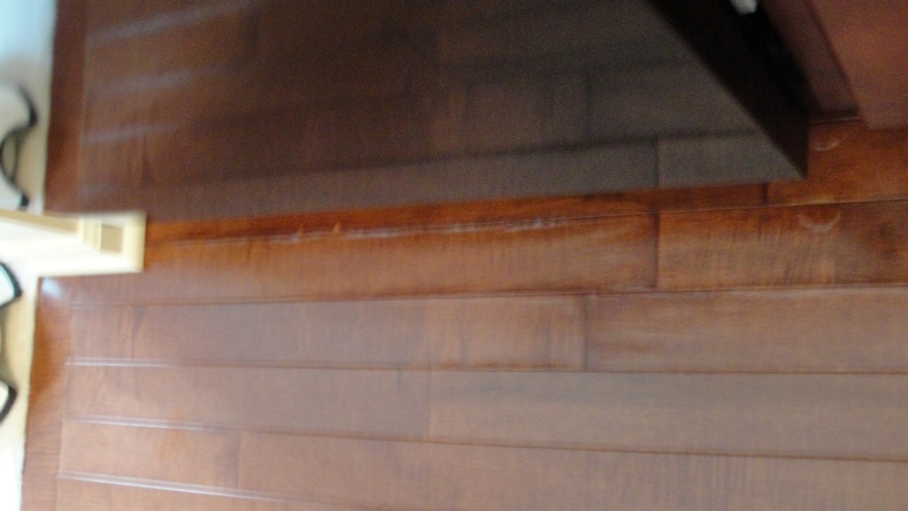

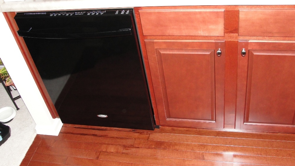

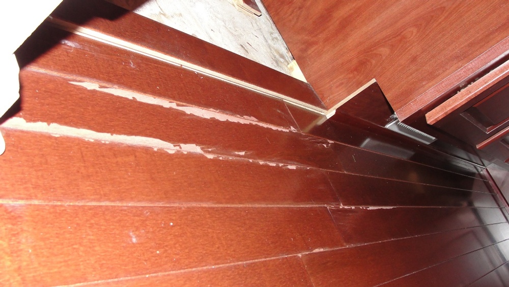

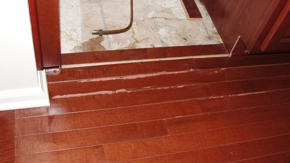

Here is the floor about 2 hours after having a fan on it... the finish had lifted and flaked off... |

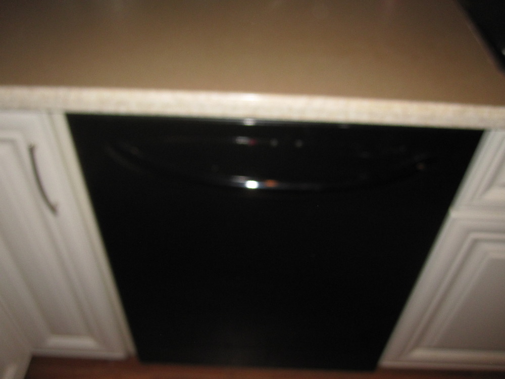

Post# 521217 , Reply# 2   5/29/2011 at 06:42 (4,715 days old) by vacfanatic ()   |   | |
1 day after... with dishwasher removed. |
Post# 521218 , Reply# 3   5/29/2011 at 06:45 (4,715 days old) by vacfanatic ()   |   | |
Beautiful... |
Post# 521220 , Reply# 4   5/29/2011 at 06:47 (4,715 days old) by vacfanatic ()   |   | |
I think I can get replacement flooring, this is standard size and Maple. The entire floor has to be sanded and refinished though... after 4 years of being installed. Sigh! |
Post# 521222 , Reply# 6   5/29/2011 at 06:50 (4,715 days old) by vacfanatic ()   |   | |

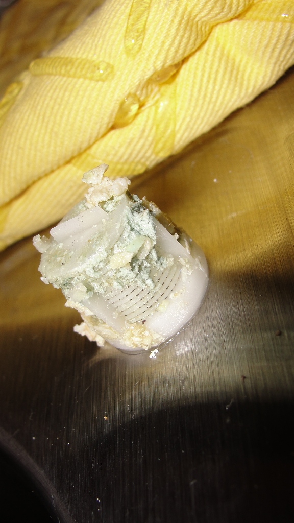

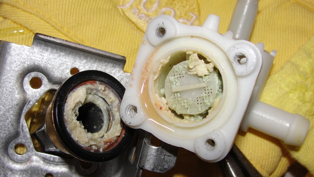

Post# 521249 , Reply# 8   5/29/2011 at 09:15 (4,715 days old) by combo52 (50 Year Repair Tech Beltsville,Md)   |   | |
All these tall tub models are experiencing a high rate of this type of failure. If you can find a new valve for $25 let me know where, they are usually $60-70. It also looks like you my have a dip-tube failing in your water heater, that may be what all that white stuff is in the screen. Sorry about your floor damage, but this is why I would never put a wood floor in a kitchen, I see this type of damage several times pre week at my customers homes. I am surprised that insurance companies don't refuse to pay for floor damage to wood floors in kitchens and bathrooms. A wood floor should never be installed in a built up fashion in front of refrigerators [ even if they don't have ice-makers, they still can and do leak ] DWs and even sink cabinets. |

It looks like you have a high calcium level in your water. Be happy that you had true hardwood floors instead of that laminate stuff. If you had, you probably would be replacing the entire kitchen floor! Laminate & water definitely don't mix! |
Post# 521287 , Reply# 11   5/29/2011 at 13:59 (4,715 days old) by DADoES (TX, U.S. of A.)   |   | |
The RepairClinic link lists the part number under their stock/item number, not the manuf part number. Looked up the model DU1055XTSB2 at SearsPartsDirect, which does include the manuf part number as 8563405 @ $38.85. PartsTap.com carries it for $20.88 (shipping $6.50). Part # W10158387 (8563405) at PartsTap.com (Whirlpool part W10158387 at RepairClinic brings up the same item # 1481084 as your link) AppliancePartsPros.com lists it for $20.86 |

Looks like a water softener would be a good investment once this trouble is over! Recent water quality report in our MUD bill listed hardness at an average of 9-13 grains through the 2010 year. The time of year and where your water comes from (either the Missouri river, Platte River, wells, etc.) can make these numbers worse. Sarpy County seems to have worse trouble with water as most of theirs is drawn from the Platte R. or wells, my parents in Gretna had theirs tested when they moved and it came out at 17 grains. I had a Culligan water softener for a while that recharged whether it needed it or not and that pitiful thing used 3 bags of salt a month. Now I have a GE softener I bought at Sam's with demand-recharge and low water & salt cycling so we only use 1/2 to 1 bag each month. With all the vintage machines as a priority plus all the other benefits, it was a money saving investment in the long run. I think it was around $350 or so, plus install but it looks like you're handy enough to get that done :-) |

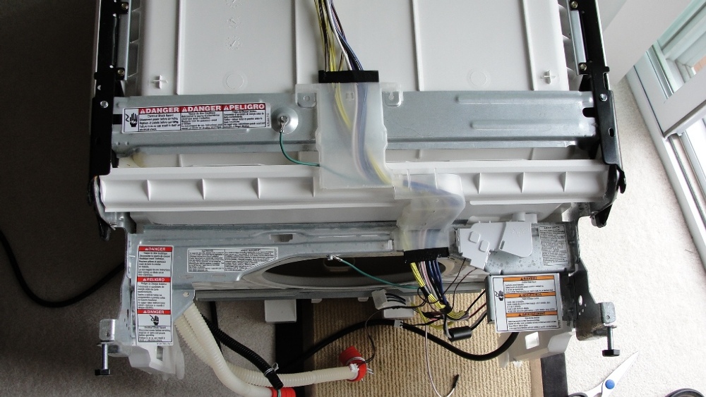

Danger my ass... more like danger to my wood floor! |

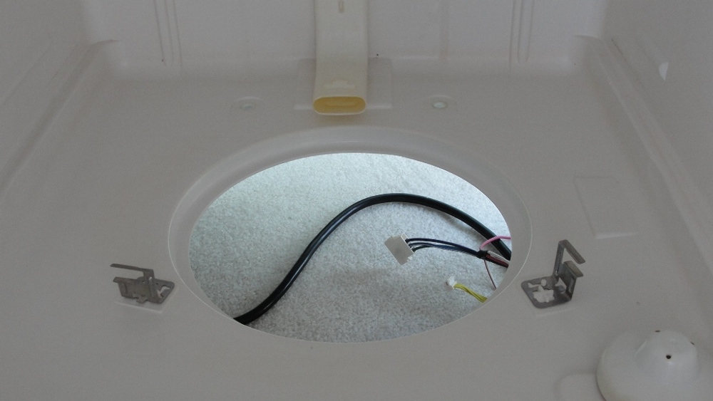

Post# 521339 , Reply# 15   5/29/2011 at 19:12 (4,715 days old) by vacfanatic ()   |   | |
All clean |
Post# 521340 , Reply# 16   5/29/2011 at 19:13 (4,715 days old) by vacfanatic ()   |   | |

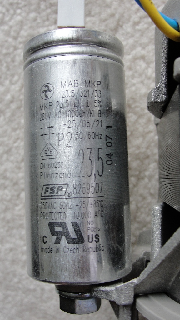

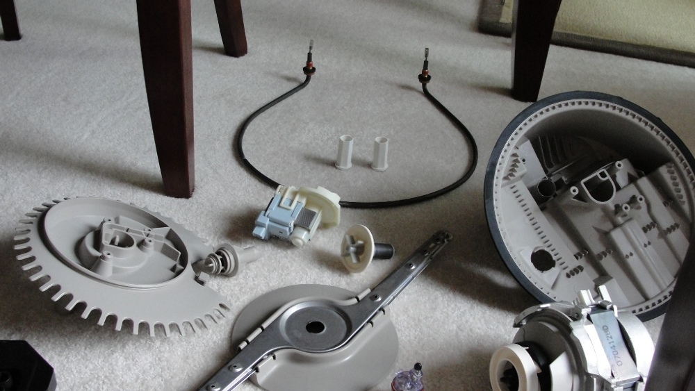

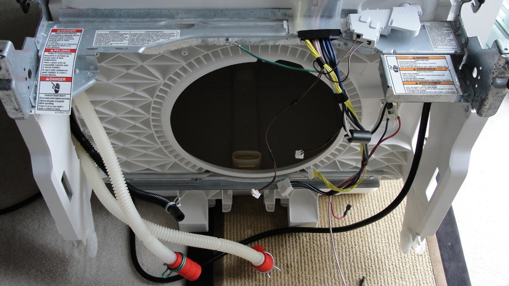

Post# 521341 , Reply# 17   5/29/2011 at 19:14 (4,715 days old) by vacfanatic ()   |   | |
Cap (Yes I discharged it before tinkering) |

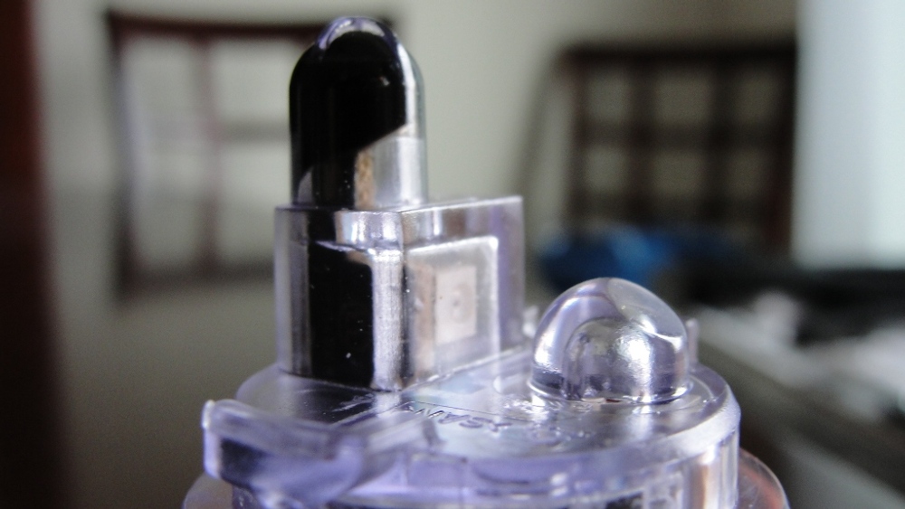

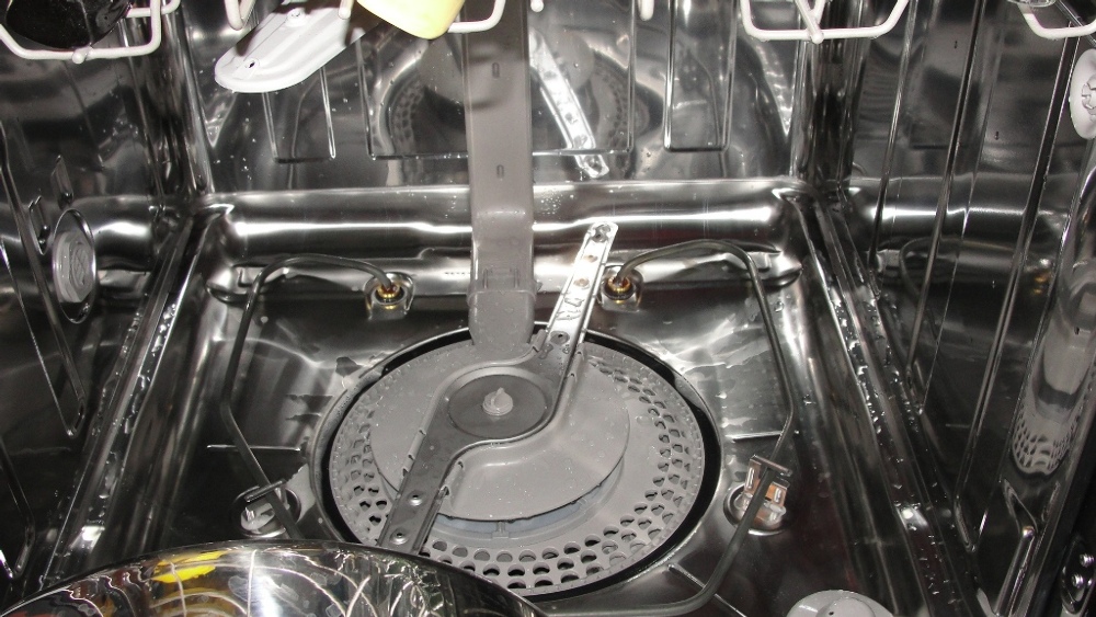

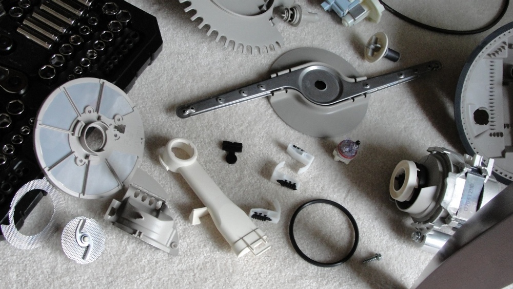

Post# 521342 , Reply# 18   5/29/2011 at 19:16 (4,715 days old) by vacfanatic ()   |   | |
Thermistor (Black Tip) and Soil Sensor lower bulb and eye I guess... |
Post# 521343 , Reply# 19   5/29/2011 at 19:18 (4,715 days old) by vacfanatic ()   |   | |
Heater holes and wash pack sealing surfaces super clean before reinstall. |

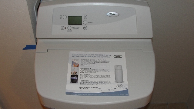

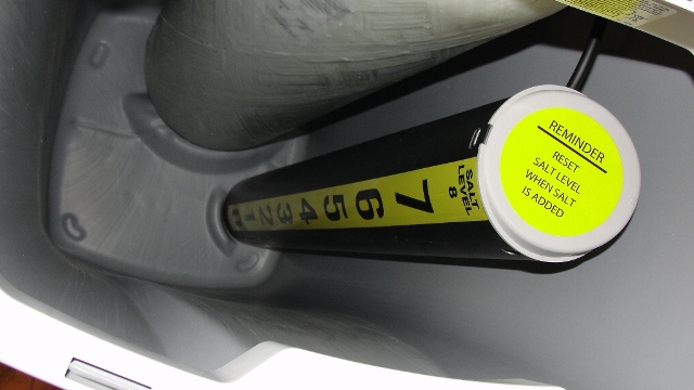

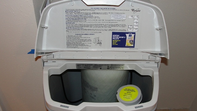

I'm excited for the new one to come. I'm going to be picking out a Water Softener this week as well. Need to do some research on them. Will probably be using potasium vs salt though. |

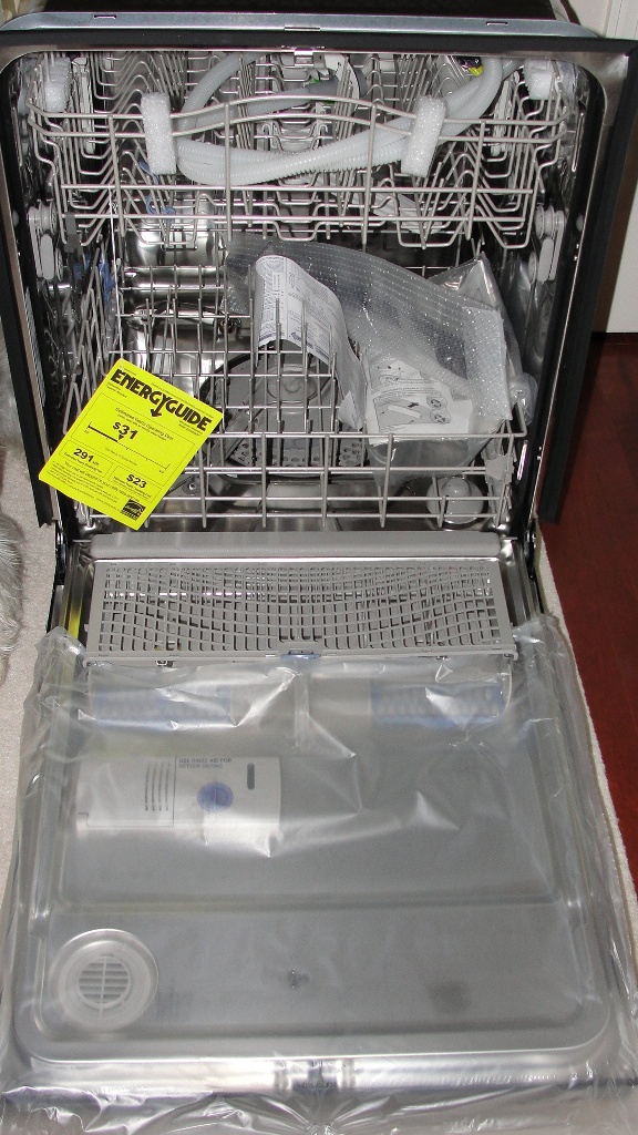

Post# 523302 , Reply# 36   6/8/2011 at 09:15 (4,705 days old) by vacfanatic ()   |   | |
Post# 523303 , Reply# 37   6/8/2011 at 09:20 (4,705 days old) by vacfanatic ()   |   | |

Andrew, you're going to love having softened water---for bathing, laundry, and automatic dishwshing. One side effect of mechanically softened water: Laundry detergents don't rinse out as well as they do in hard water. I've learned to live with a bit of suds in the final rinse. But that minor trade-off is well worth all the positives!

Post# 525725 , Reply# 44   6/20/2011 at 06:28 (4,693 days old) by combo52 (50 Year Repair Tech Beltsville,Md)   |   | |

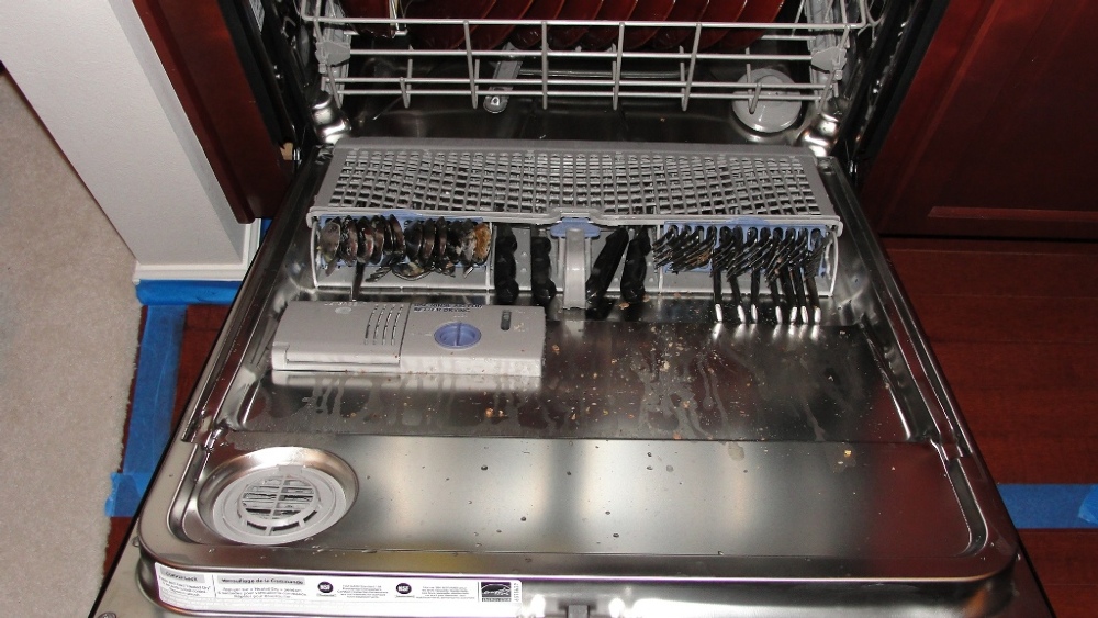

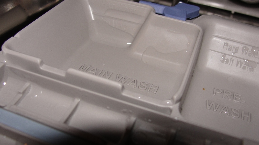

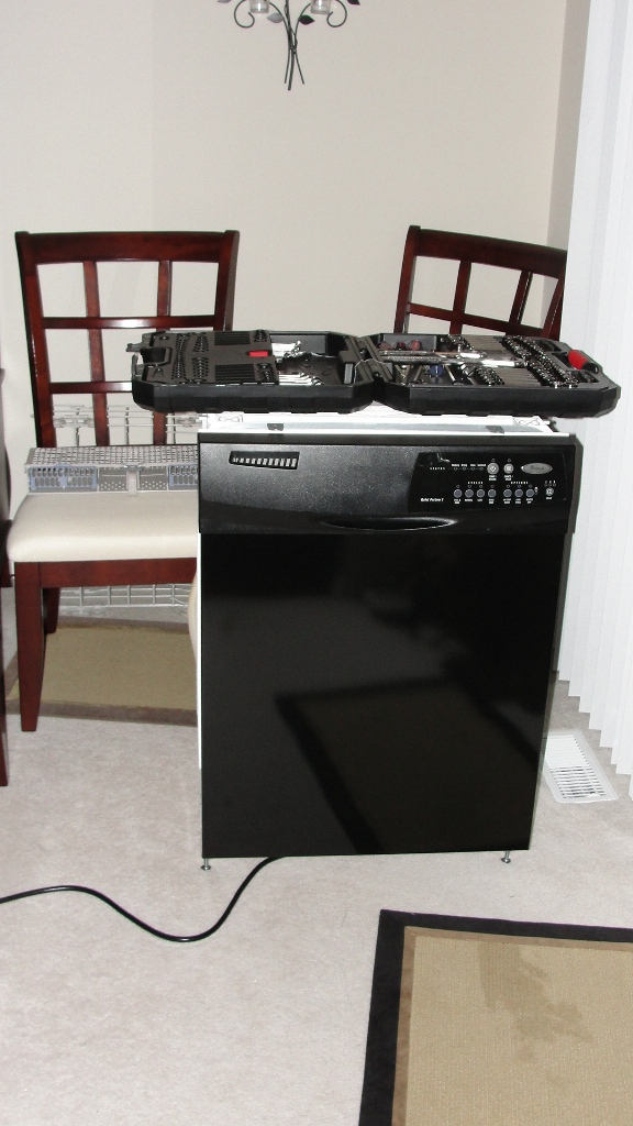

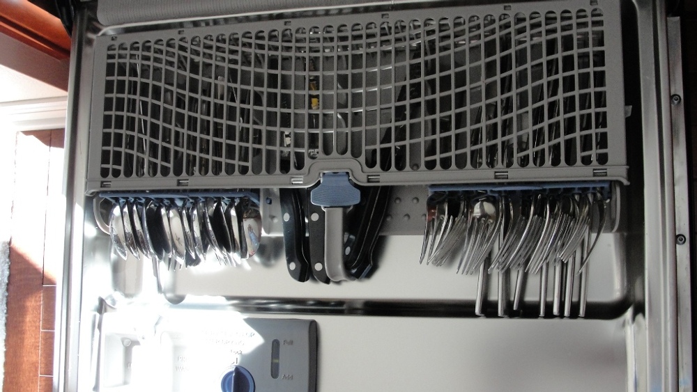

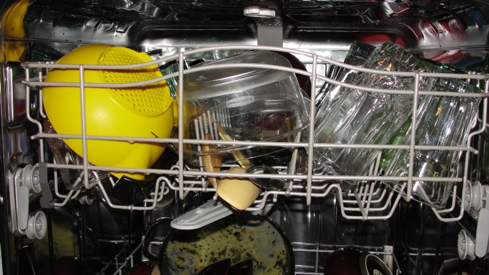

Here are the 2 slots on the top side of the dispenser when the door is closed. Allows water to fill the main wash dispenser. |
Post# 526358 , Reply# 57   6/22/2011 at 22:39 (4,691 days old) by vacfanatic ()   |   | |

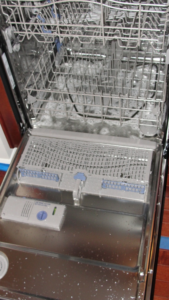

Here is the last shot. Floor didn't turn out as well as I wanted, but it looks better than it did. Eventually will strip, sand, and refinish the entire kitchen floor. |
Post# 526547 , Reply# 60   6/23/2011 at 19:15 (4,690 days old) by vacfanatic ()   |   | |

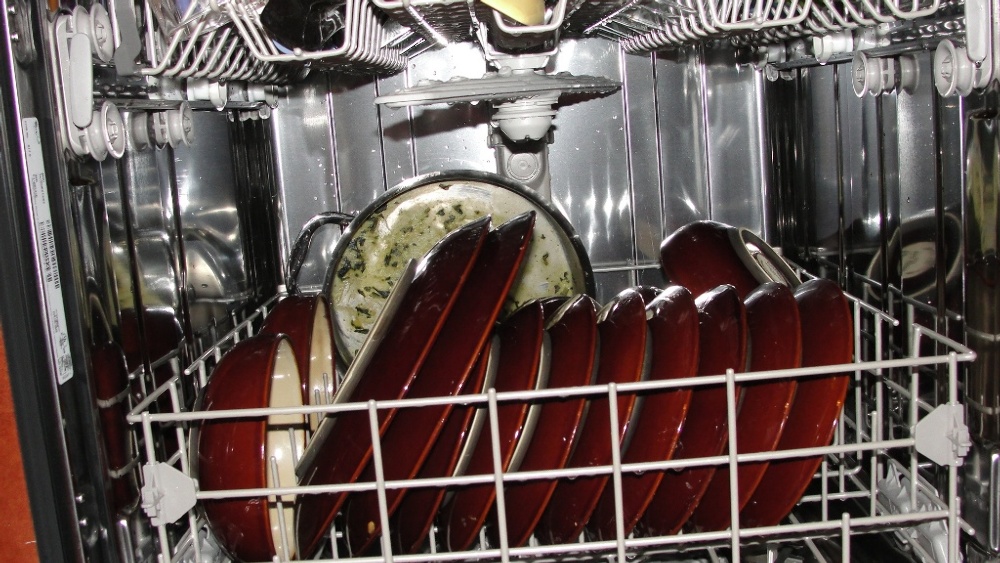

Post# 526617 , Reply# 61   6/24/2011 at 07:43 (4,689 days old) by combo52 (50 Year Repair Tech Beltsville,Md)   |   | |
I would keep an eye on how well that works as it looks like it may allow the detergent to wash out too soon. I would wait for the lid to open and see if your detergent is still there. KA tried this nonsense to improve rinsing on the later KD24 machines where they removed the det disp gasket from the lid of the DD at the factory. At first we thought they had just been left off, but then they told us that it had been done on purpose to solve other washability problems they were having. Then when the inside of the DWs starting developing a white film and the dishes had the same film on them they started selling us the gaskets that they removed and suggesting that they be installed.
But in any case I would keep a good eye on the DWs performance, however now that you have soft water it will probably be much better than the last one. I hate to sound like old timer but having had a TT KA DW and a TT WPDW and a TT GE DW installed in my kitchen I will never have one again. They just don't do the job that the standard machine does. Yesterday I installed two the the standard KM ultra DWs, we buy about a dozen per month and I guess when WP stops making them I will stop selling DWs and let it be someone else's headache

Post# 526622 , Reply# 62   6/24/2011 at 09:00 (4,689 days old) by mark_wpduet (Lexington KY)   |   | |
Oh cool!
You finally got it! LMAO..........You didn't wash dishes for three weeks..... It looks GREAT! I like it Gosh, I was kind of hoping they redesigned that detergent/rinse aid dispenser. I haven't been able to use Rinse aid for the past two years because it leaks down the door...When I googled that problem a LOT of hits came up, so I thought it was a design issue. Mine didn't start leaking until year 4. |
