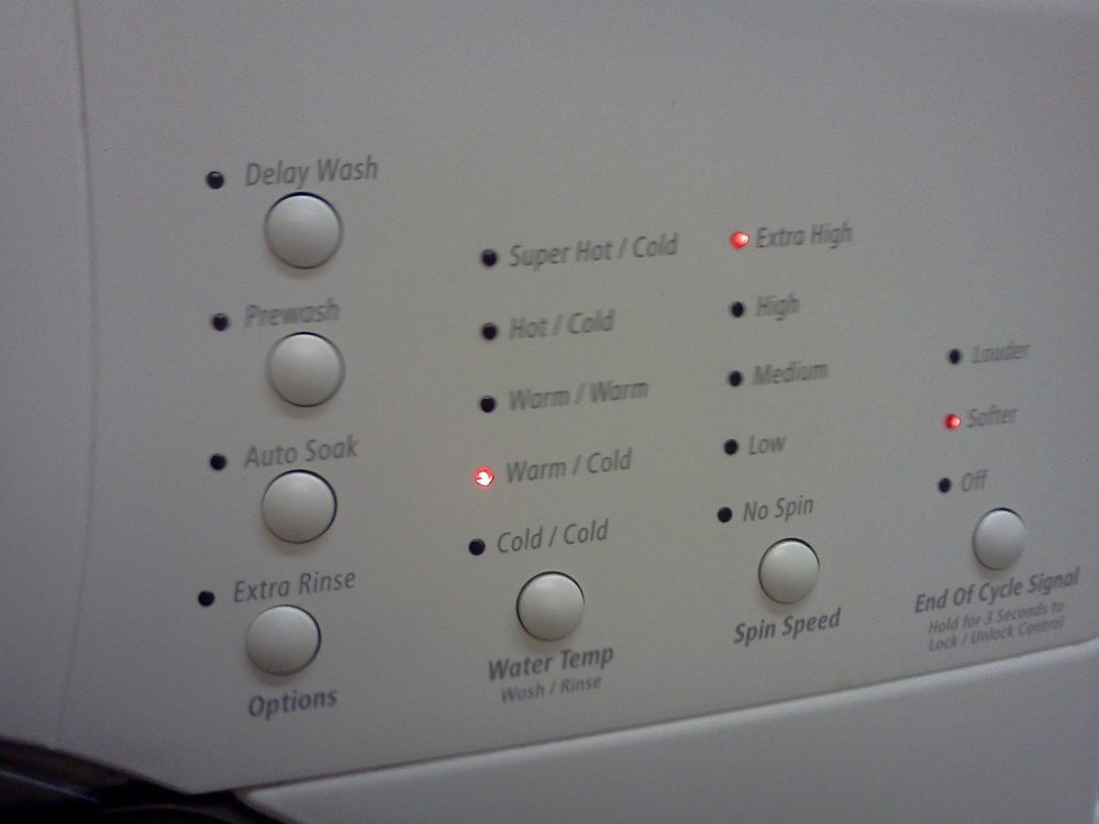

I'm not sure which Duet Washers this applies to, but it totally worked with mine. Mine is almost 7 years old and (with the Redish pink and green start and stop buttons). There is a hidden clean washer cycle
1. Empty washer. 2. Take out detergent divider in dispenser drawer 3. Select POWER button Select RINSE/SPIN Select LOW SPIN speed Set the Warm/ cold water temp Set end of cycle signal to Softer Push Extra rinse button 4 times Door will lock Machine will run for 3 minutes 4. After 4 beeps check washer for codes: AD. Add bleach. 1 c first time, 1/3 c thereafter To detergent Compartment 5. After cycle is complete, leave door open to air. PS. I didn't add that much bleach. To me that's too much. I suppose you could also do this with white vinegar if you want. It was pretty wild to watch ALL that water spinning rapidly in the tub. I've seen it on videos but never in person. I can't believe my machine has had this capability all this time and I didn't know it. It's not in the manual. I only learned of this thanks to a fellow poster. |

When you press the buttons in order, the first thing you see is the timer go to 45 minutes, then it fills with water for about a minute then drains that water, then you see (AB), not AD (that was a typo) where the timer is which means add bleach.......The water is actually running into the machine at the same time you see (AB), so you just have to pour your bleach in or whatever you want to use through the dispenser as the water is running

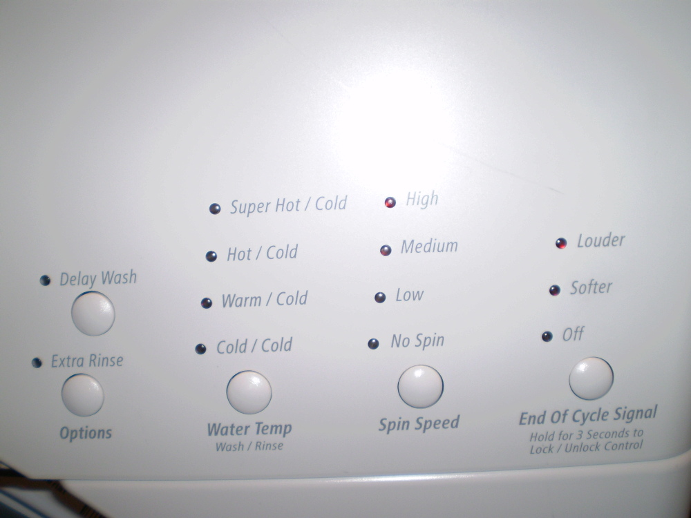

2
Here is a sot of my controls, looks like I have a few more options then Mark has. I mostly only use the basic Normal cycle. |

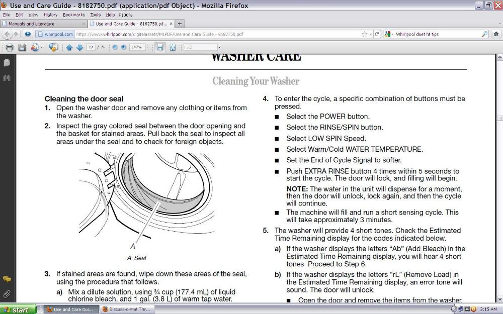

Matt.
If you go to the whirpool site and do a PDF search (I searched for ghw9250, ghw9300 and ghw9400) and it brings up all the model PDF's within those model #'s. There are several in each one. And in some of the PDF's, it gives the exact sequence in "washer care", and some of the model PDF's it doesn't have that at all. You would think if it's NOT in your manual, that it wouldn't work for your machine, but it IS NOT in my manual that came with my machine, yet it works. Here's a screen shot. Obviously it's the same sequence no matter what model Duet HT you have, so if it's not working with yours, I don't think it's going to work :( |
