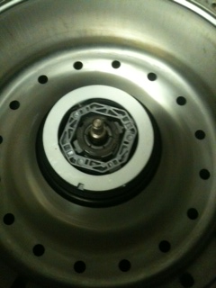

Just put a new u joint kit in the calypso. There was a bonking noise that was getting worse. The old u-joint had some play in the inner part and I think there wsa also a problem with the leveler. The old one had a yellow gasket with a plastic bottom and the seal seemed to snap around the ujoint - the inner dome was clear plastic. The new one has a black gasket but it doesn't seem like it seals very well. There is some space between the gasket and the new u-joint. Is it supposed to be like that? There was no water in the old one, just hope water won't get in the new one. The pic doesn't show much.

Your original mechanism was the original design, with a translucent inner dome, yellow boot, and a separate yellow gasket to seal them. There was a redesign mid-production which changed to a brown inner dome, black boot, and eliminated the separate gasket. Components cannot be mixed between the two designs, a brown inner dome must be used with the black boot. I've not found info regarding how crucial is the thin foam seal. It's included only with the u-joint kit, not in the separate seal kit (o-ring under the u-joint and six bolt grommets). |
