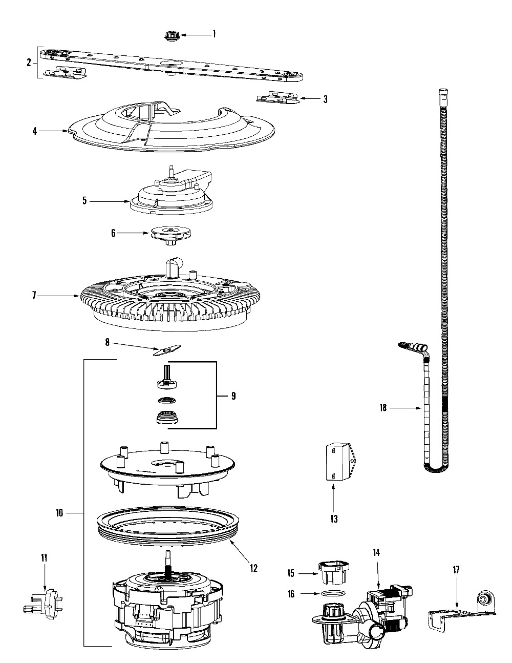

Post# 546220 , Reply# 7   9/27/2011 at 21:02 (4,594 days old) by mrclean87 (Southcentral, Pennsylvania)   |   | |
Thanks to all for the information. Here's the model number of the dishwasher MDB7600AWS. What other types of problems are these dishwashers known to experience? We do frequently hear a rather loud, grinding type noise |
Post# 546251 , Reply# 8   9/28/2011 at 00:05 (4,594 days old) by volsboy1 (East Tenn Smoky mountains )   |   | |
That's simple the pump of this dishwasher is very simple device really.You need to take off the wash arm and screws holding down the strainer.You have something caught in the hard food grinder all water goes through the grinder (#8) and sizing screen is in the center of number 7 before the pump. Here is a schematic

The 'new and improved' latch has metal pivots on the handle and lasts better than the old, generally... I don't sweat the broken 'keeper' tabs on the console as they are small and not very resilient. The latch assy's I replace last just as well without replacing the console. Make sure you've checked the Maytag website as many of the plastic tall tubs of that era are under a recall for the heating element. If it is, it's a quick and FREE repair. The grinding is most likely some crap caught in the sump that's hitting off if the chopper blade. I find all sorts of things like pistachio shells, bread bag closers, broken glass, etc...
