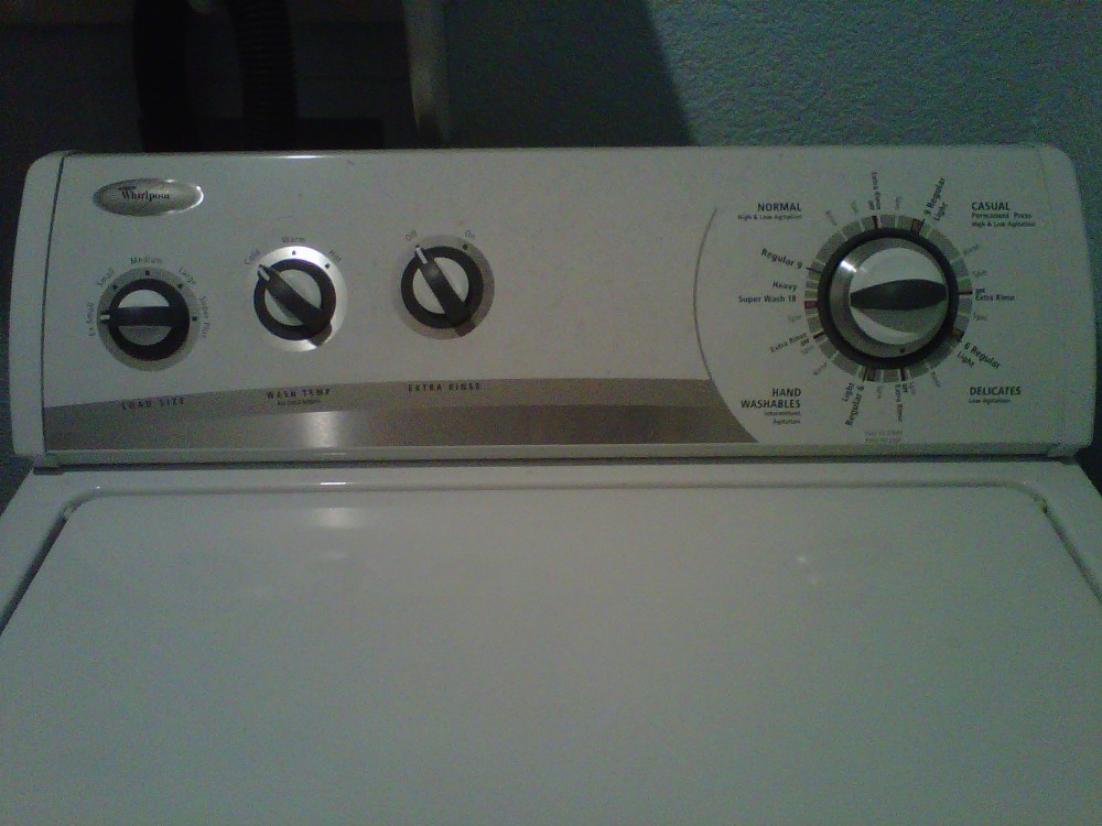

Hello - My Whirlpool top loader recently finished a load with a few smudges of a grease of some sort in several spots near the bottom of the tub so I'm considering a new machine. Since real Maytag Dependable Cares are no longer available, I'm considering a Speed Queen, (not ready to move away from a traditional top-loader. I'm thinking of the AWN432 because it has two speeds, and a second rinse option.

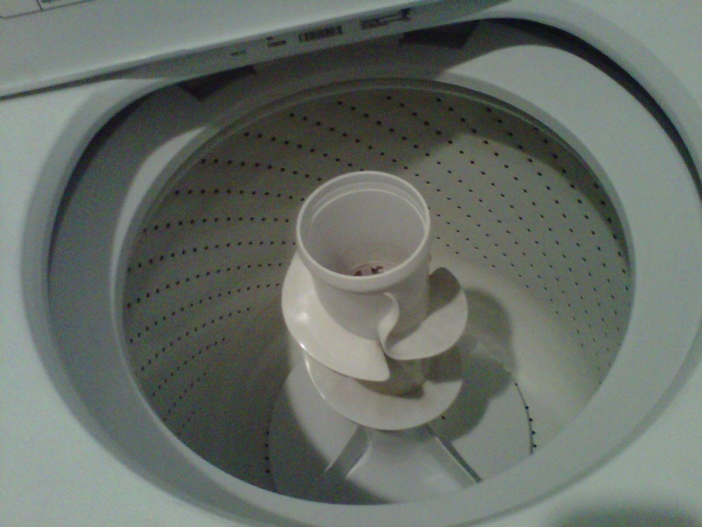

I don't use fabric softener, so it's not that. I usually use liquid Arm & Hammer and I double rinse most stuff so I think it's unlikely. I did notice when I got the machine that unless you remove the agitator fabric softer dispenser mildew builds up inside that area, so I long ago removed the dispenser. Perhaps I should remove the agitator...if I could figure out how!

Post# 547910 , Reply# 9   10/7/2011 at 00:17 (4,584 days old) by Volvoguy87 (Cincinnati, OH)   |   | |
Inside the agitator's middle, there should be a plastic cap, remove it. Below that, there should be a bolt, remove it too. Pull the agitator up from the bottom. Don't hit yourself in the face with it.
You have a 2-piece agitator. The upper part has the corkscrew blades. It will pull off the lower portion with the fins on the base so long as the bolt is out. Look inside and see what you find. Be mindful of the ratcheting cams in the middle. That assembly is what drives the upper portion of the agitator. If you loose the dogs, they'll run you about $4.00 for a new set. The Direct Drive is a good washer. It's reliable, easy to work on, and has a long and solid reputation. Dave PS: The agitator dogs are part #80040, in case you need them. |
