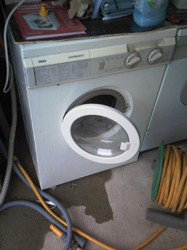

Andy
Welcome to AutomaticWasher It should be a very easy job to add another machine - you just need a couple of Y connectors for the water feeds and possibly cut another connection into the stand pipe for the waste, although that may not strictly be necessary if you are running the machines one at a time. All equipment and tools easily available at Hombase/B&Q. The one thing you need to be careful of is that when fitting the Y connectors to the taps that, once the hoses are connected to the machines that there is not undue physical pressure (i dont mean water pressure) on the taps that could give rise to leaks. If you are not sure just buy extra hoses with male/male connectors to make the joing from tap to Y connector. In this case the sequence is Tap/Hose/Male-nale Connector,Y connector, hose to each machine - one of these for hot and one for cold. Again all easily available Al |

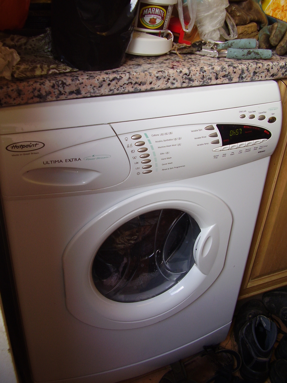

Post# 552800 , Reply# 4   10/30/2011 at 14:19 (4,576 days old) by andyzanni ()   |   | |
that's great. So I can attach the cold fill to my Hotpint using a Y or T piece, and attach the hot fill using another Y piece to my Zanussi? |
Post# 552802 , Reply# 5   10/30/2011 at 14:35 (4,576 days old) by andyzanni ()   |   | |
I wil have a look behind my Hotpoint to see what way it is all plumbed in !! I don't even recall seeing 'taps' lol .... |
Post# 552803 , Reply# 6   10/30/2011 at 14:39 (4,576 days old) by AquaCycle (West Yorkshire, UK)   |   | |
Ey up dude! Thought it was you when I saw the location :P.
Behind the Hottie should be 2 inlet pipes - 1 hot and 1 cold. I believe your Hotpoint WMA is cold fill only, though someone on here will correct me if I'm wrong. If it is, you'll only need 1 Y piece to fit to the cold inlet. These just screw onto the pipe in place of the washer hose. You should be able to connect the Zanussi to the hot fill as usual. Should all be pretty straight forward. You can also get self cutting drain attachments from Homebase if you need it draining. Again these are dead easy to fit if you follow the instructions provided. |
Post# 552805 , Reply# 7   10/30/2011 at 14:42 (4,576 days old) by andyzanni ()   |   | |
well at the min the Hottie has red and blue pipes feeding into the back of it- im yet to pull it all out, so I'm not so sure yet! I will give it a try anyway!! :] |
Post# 552807 , Reply# 8   10/30/2011 at 14:46 (4,576 days old) by AquaCycle (West Yorkshire, UK)   |   | |
Oh, in that case it's hot and cold fill - I could've SWORN the WMA's were cold fill only. Oh well, you live and learn.
But yeh, it's all very straight forward with the Y pieces. Just screw one into each of the hot and cold feed's and then the correct pipes into the ends of the Y's :). And make sure you get some pics of the setup once you're done. |
