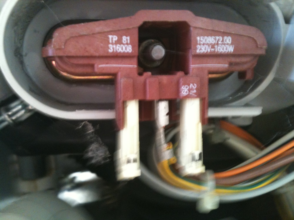

Hey everyone :)
I got round to opening the machine up yesterday. I found that the bottom weight at the front of the machine was just a tad loose, which caused that awful noise. Thankfully the machine was no longer being used and it didn't come apart. It got tightened and is working as normal. I put in a towels load, it worked as normal. I think its not heating as its a hot and cold fill machine the wash water was just warm as the usual 50oc wash is warmer at the touch. The hot water that is taken in for the main wash is very hot as the boiler is situated not far from the washing machine. What could be causing the heating problem, loose wire? Help much appreciated :) Thank you all :) |

Thank you very much :)
The cycle is running as it should, washing, doing its distribution washing, spinning etc when it should. The tips looked fine to me, I removed the plugs and put them back on to see if that would cure the problem but it didn't. Should I get a new heating element? As with the soldering, i'm not experienced in this field so wouldn't want to mess anything up as the machine still seems to have some life in it. I know a lot of people had problms with Hotpoint WMA series, but none with this even with daily use which is impressive :) |

Hey Steve
I have tightened the concrete weights so the noise has stopped which is good as we no longer need to purchase a new machine :) The machine doeswn't heat the water, think i'm going to order a new heating element and hopefully that should sort the problem as it has been running problem free for atleast 8 years or so now. Thank you |
