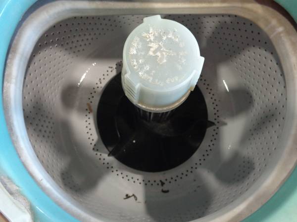

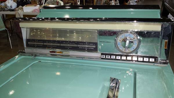

Post# 698761 , Reply# 8   8/25/2013 at 08:11 (3,897 days old) by brucelucenta ()
I went and looked at them earlier in the week. First of all, the washer has no motor and the suds saver valve is broken off where the hose connects. It is made out of pot metal and basically corroded and broke. Second is that they ARE NOT a matching set. The washer is a Lady Kenmore, but the dryer is not. It is fairly close as a match to the washer, about the same vintage and such, but it is obvious that it isn't a mate to the washer. I really question whether they are worth $300. I guess they are worth whatever someone will pay for them.
Post# 698774 , Reply# 9   8/25/2013 at 09:50 (3,897 days old) by Kenmore71 (Minneapolis, MN)
kenmore71's profile picture
Intersting notes about the pair. The corroded suds valve is par for the course on a machine of this age. They are NLA but not really that hard to find in plastic. KM/WP used the same valve from about 1950 all the way through the DD suds savers into the 1990s. These machines can also be operated perfectly as a non-suds machine by plumbing around the valve.
The missing motor is FAR more problematic. This machine used a 3 speed motor which inluded an EXTRA SLOW agitation option. You can certainly put in a more standard 2-speed motor in this machine but you then you lose the extra slow agitation. In my opinion I still think the price is reasonable for that color in that cosmetic condition.

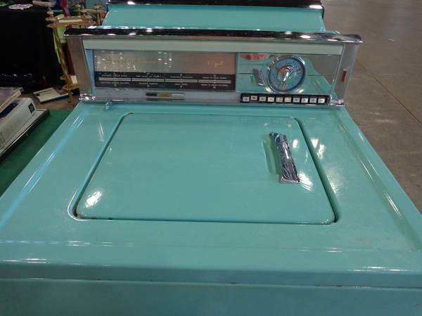

Post# 698784 , Reply# 11   8/25/2013 at 11:40 (3,897 days old) by retropia ()

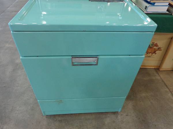

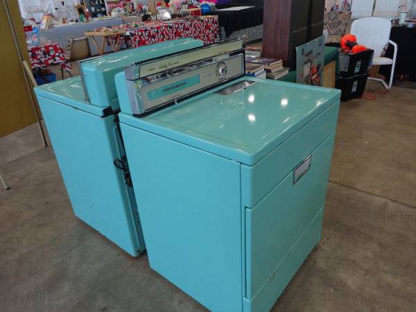

New photos
The seller posted more photos when she reduced the price.
Post# 698786 , Reply# 12   8/25/2013 at 11:41 (3,897 days old) by retropia ()
Dryer view
Back-to-back

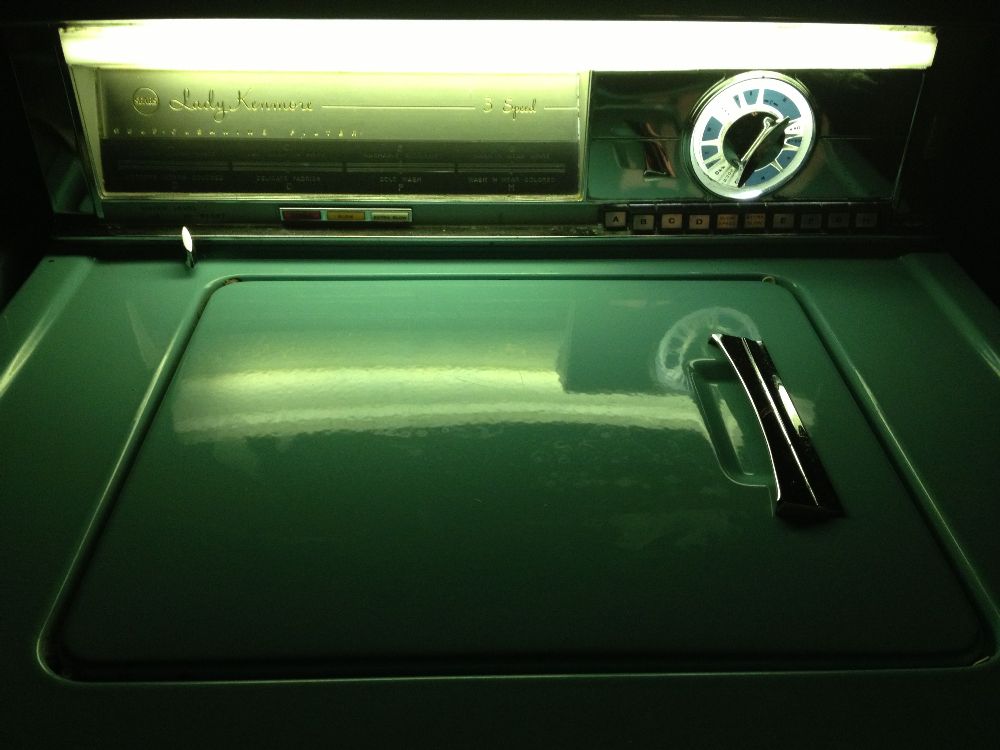

Post# 698787 , Reply# 13   8/25/2013 at 11:41 (3,897 days old) by retropia ()
Washer
Looks shiny
Post# 698788 , Reply# 14   8/25/2013 at 11:42 (3,897 days old) by retropia ()
Money shot
Agitator and tub

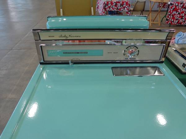

Post# 698789 , Reply# 15   8/25/2013 at 11:43 (3,897 days old) by retropia ()
Dryer
Console

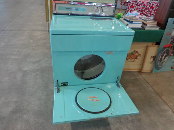

Post# 698790 , Reply# 16   8/25/2013 at 11:44 (3,897 days old) by retropia ()
Dryer
Front of dryer
Post# 698791 , Reply# 17   8/25/2013 at 11:44 (3,897 days old) by Kenmore71 (Minneapolis, MN)
The dryer IS a Lady Kenmore.
It is the 1965 model.  The clear plastic push buttons were only offered on the 1965 Lady Kenmore models, although that "model" was available until well into 1967. This particular dryer is an early-ish production version since it is in Turquoise and it has the older style drum. By sometime in 1966 or 67 this model dryer would use the revised drum with the stationary rear bulkhead and turquoise had been dropped in favor of shaded avocado.

Post# 698793 , Reply# 18   8/25/2013 at 11:46 (3,897 days old) by retropia ()
Dryer open
If the set doesn't have to be repainted or rechromed, this seems like a really good price, even if it does need some mechanical work. Cosmetics are usually the most expensive part of any restoration.

Post# 698947 , Reply# 20   8/26/2013 at 04:43 (3,896 days old) by brucelucenta ()
I stand corrected, the dryer is a lady kenmore. It is not the mate to the washer though. I looked at them both and it clearly doesn't match the washer, so perhaps it is a different year.
Post# 699015 , Reply# 21   8/26/2013 at 13:49 (3,896 days old) by Unimatic1140 (Minneapolis)
Yes it looks like the washer is a '64 model and the dryer is a '65 model. They are not a matching set.
