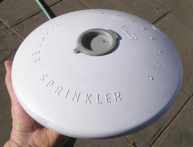

I don't know what material was used to make that grey stopper, but I've never seen one that wasn't as hard as a rock, and they couldn't have been that way when they were new. A while back I bought a new old stock one from a long time Maytag shop here in Burbank. It was still in it's original packaging and had never seen the light of day, and yet the stopper was completely hardened. So I'm kind of under the impression that today most folks have these as display items. If you wanted to use it, new rubber stoppers designed for piggy banks fit the hole very nicely, but you'll break the original stopper trying to get it out.

You could always draw up the required amount of water in a flavor injector (available in many cooking stores) and squirt if in through the hole in the stopper. |

....These didn't all have that rubber stopper problem. Now that I have a HOH dryer (a DE806), it would be great to have the accessory; I'm wanting to get into using real starch again. The only question would be how to use one with an electronic-control dryer; there's no timer to set for the same number of minutes as ounces of water used, plus five minutes.

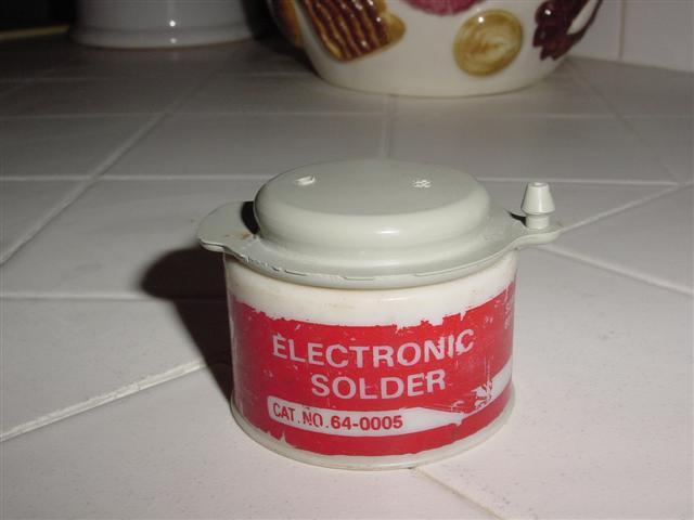

This is what those plugs look like when removed. As I mentioned, this one's as hard as a rock and came out in three pieces. The long flange at one end that says "LIFT" broke off, as did the little nipple on the other end that's meant to keep it attached to the sprinkler. I glued them back together, but it will never be installed again. I also noticed that it seemed to have shrunk some and was able to rattle a bit when it was still installed, which means even if you injected the water into it as some have suggested it would leak around the plug.
The link below takes you to a web site that sells plugs for piggy banks and other things, and I think the 1 3/4" plug shown would do the trick. You'd still have to plug the hole that the little nipple fits into, but that shouldn't be that hard to do.

I have half a mind to search out one of these beauties despite the stopper problem - the advent of 3D printers should make it possible to replicate the stopper. There are rubber-like flexible polymer materials available for 3D printing that would be suitable replacements for the rubber of an original.
The problem would be getting the dimensions right, since originals have shrunk. But it should be within the realm of possibility to restore one of these to full operation and an original appearance. Stratasys even has a grey flexible polymer available. This post was last edited 11/02/2013 at 12:21 |
