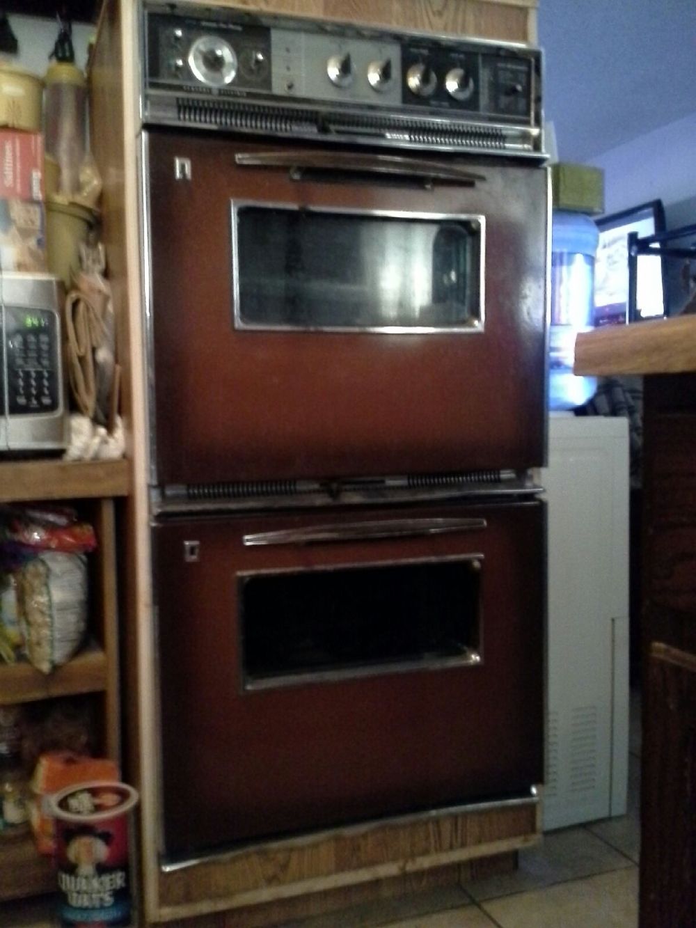

Hi John!
We have a question in another thread about a GE JK29 double P*7 wall oven - the TOL model where both ovens are P*7, not just the top one. The owner, Christina (hippiedoll), is unable to get the self-cleaning latch to operate on the lower oven. She says she's able to operate the one on the top oven, but not the bottom one. Some of us have tried to offer suggestions, but Christina's still having trouble. My own experience with these ovens is limited to baking in them from time to time over the years (and they are excellent bakers!); I don't have day-to-day experience with using the P*7 feature. Given that these units have one set of timer controls, is there some way of "toggling" between the upper and lower ovens when operating P*7 features? Or does Christina have a bigger problem? A link to the original discussion is below. We were hoping you'd see it, but it has gotten shoved way down in the thread listings. Thanks for any light you could shed! CLICK HERE TO GO TO danemodsandy's LINK |

Post# 725403 , Reply# 4   1/5/2014 at 23:00 (3,774 days old) by combo52 (50 Year Repair Tech Beltsville,Md)   |   | |
Yes I am hiding here in Minnesota where it is currently -20F, but am staying very warm.
It sounds like you know how to set the SC function on this oven, but keep in mind that only ONE oven can be SCed at a time, if you have the top oven set for SCing it will block you from cleaning the bottom oven at the same time. Other than this it is broken so unless you have a really repair person around and you don't mind a potentially expensive repair you may want to get out the oven cleaner considering the age of this oven. If you do get someone to look at it and need a part let me know, many of the parts for this oven are NLA, but we have lots of good used parts for these ovens. John L. |
