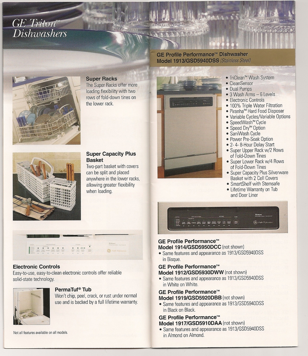

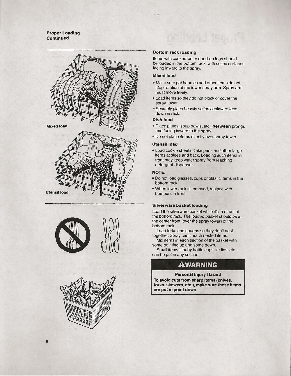

Being I was doing some scanning - I thought I would go through some designs concerning dishwasher interiors that were poorly designed to load dishes. I am very interested in getting other input!
We will start with the GE Triton from 1999 when they added a wash arm with the tower. Sort of a mishap after the potscrubber2 and makes more difficult loading with the tower as a addition!

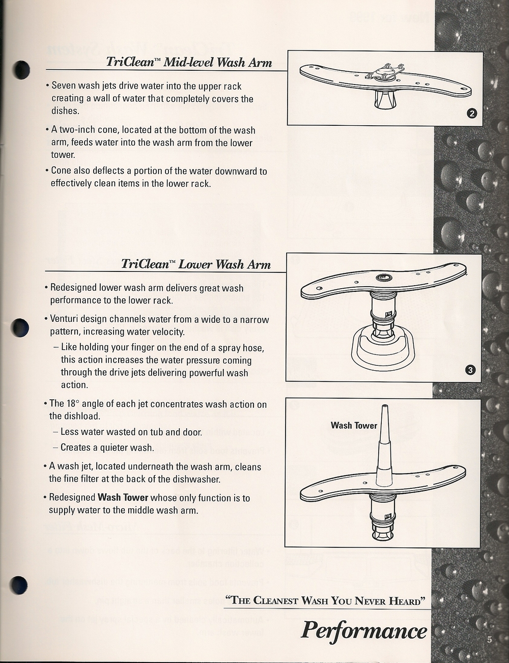

Now what were they thinking - they could have had a feed going up the back of the machine!

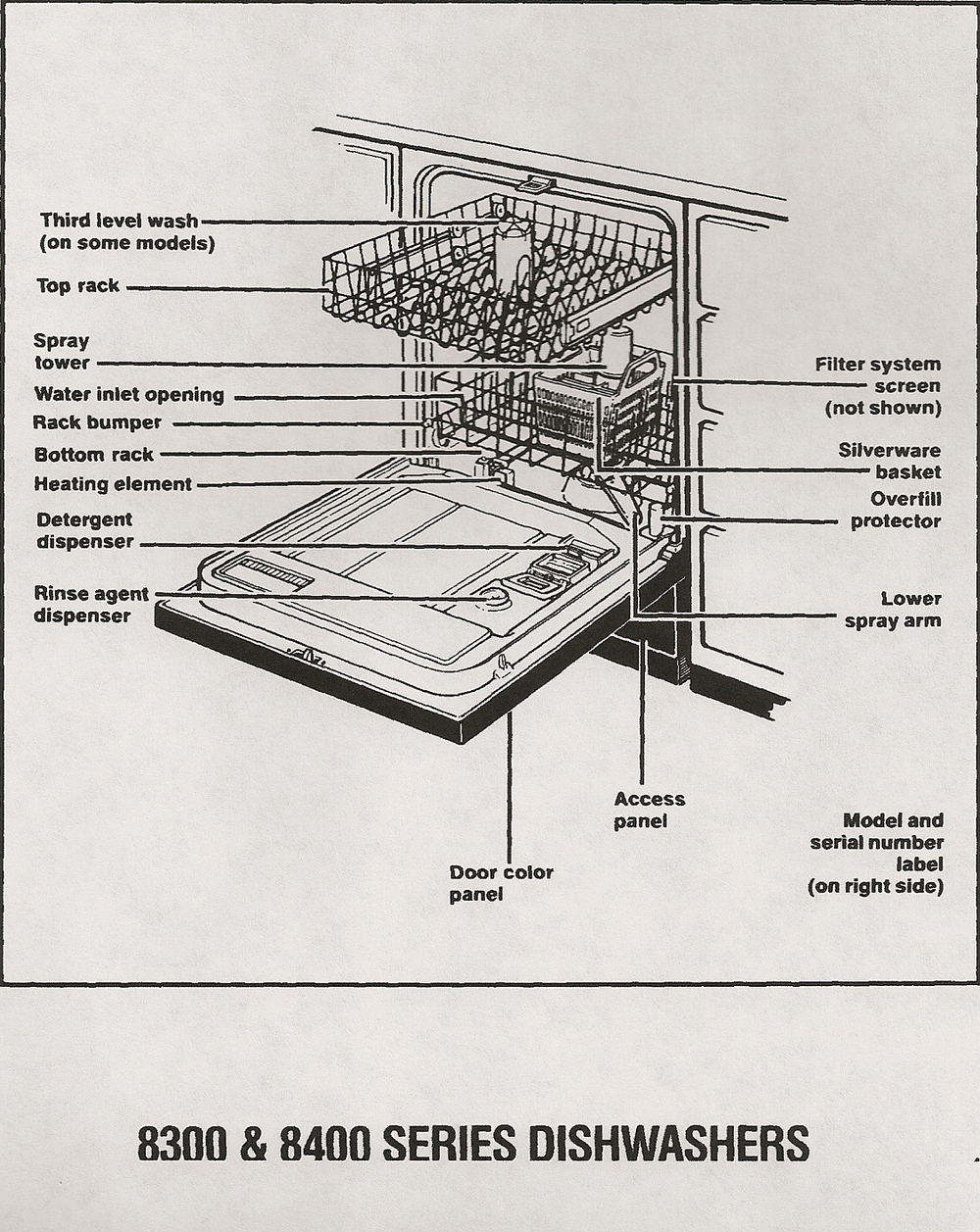

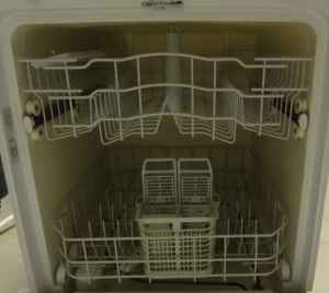

Now for whirlpool! This is real disappointing especially being the better models were so much better in loading!

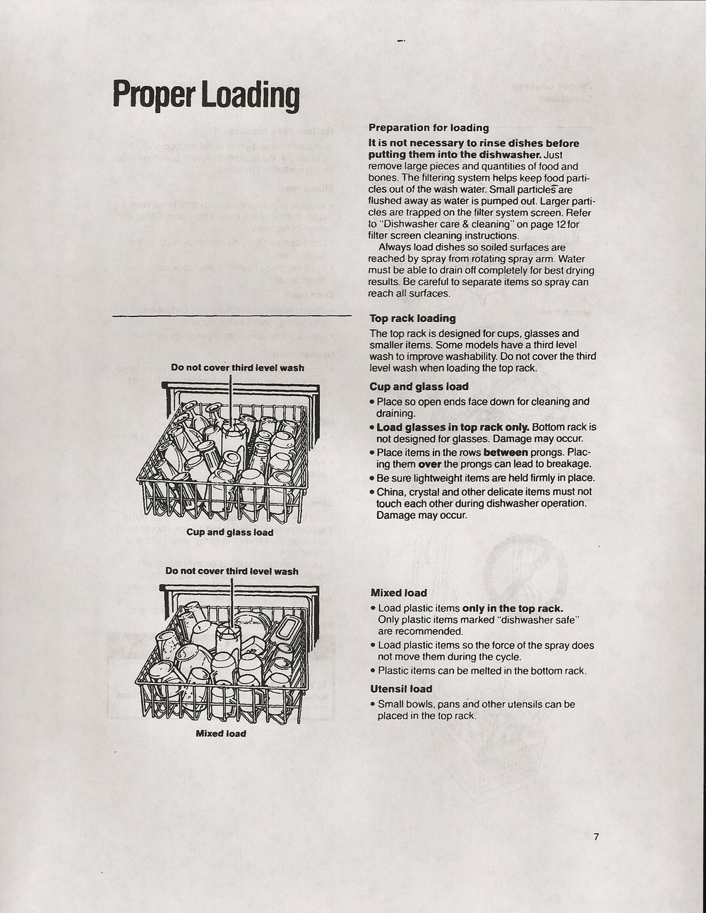

now tell me where I'm supposed to put the dishes!

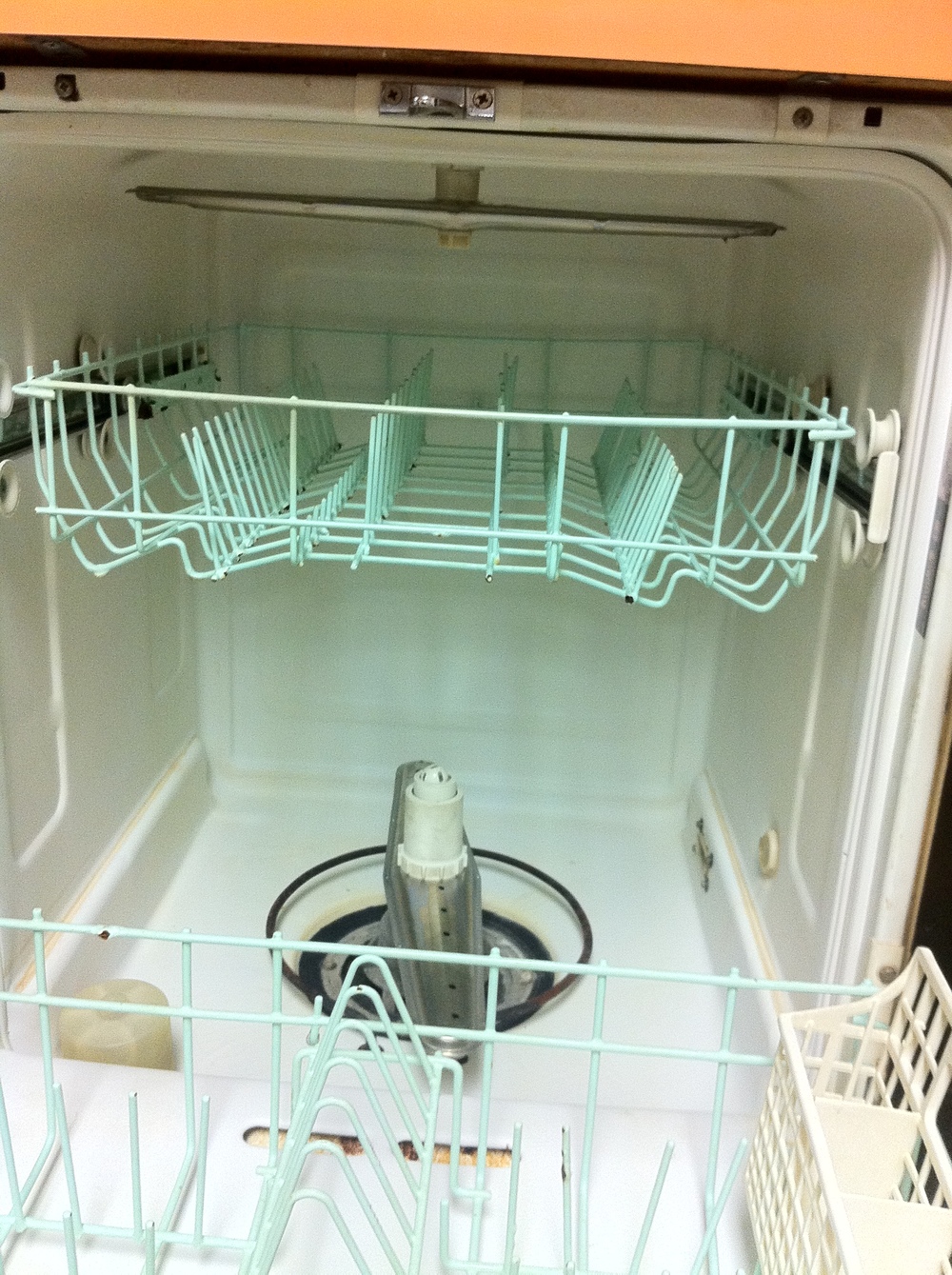

With a tower already why did they have to add a top cone to make loading harder!
Post# 504217 , Reply# 11   3/15/2011 at 08:30 (4,790 days old) by magic clean ()
Peter
some GE machines don't have a tub mounted power shower. So this upper rack tower serves that purpose. There is a vertical jet of water from the power tower that is diffused over the top of upper rack by the upper rack spray tube.

I have the whirlpool design in my apt, it does hold less dishes and the lower rack is comprimised on space for big items, however it does an excellent job in cleaning over all!! Ikea sells this model under thier brand name too, if I where to by a "buget level" model it would be the one of these whirlpool models, I would wrap it with insulaton though it is a little on the loud side
Post# 504683 , Reply# 14   3/17/2011 at 00:40 (4,788 days old) by autowasherfreak ()
I have a Whirlpool like the one in post #500870, it is a real pain to load and doesn't hold a lot because of those tubes.  I can get more in my KitchenAid 21.
