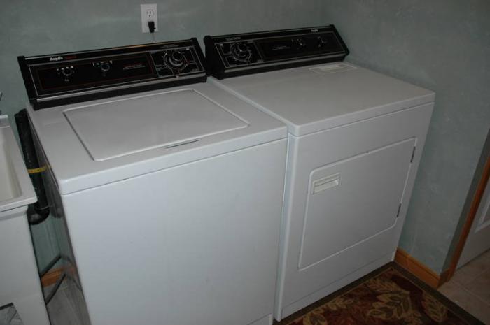

Post# 503574 , Reply# 3   3/12/2011 at 17:23 (4,885 days old) by pierreandreply4 (St-Bruno de montarville (province of quebec) canada)   |   | |
me my 1993 inglis whirlpool superb2 had this setting by default it would wash on high agitation for about 10 minutes on the 14 minutes wash setting on the timer but to have that 10 minute i pout the timaer on the 6 minute super wash and that includes an auto soak then it would fill for normal wash but when 6 minutes would be remaining it would change to the gentle agitation it was the washer model on the following picture
