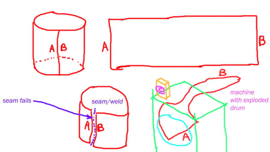

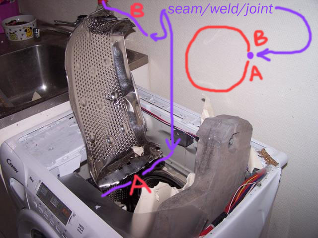

![]() This is what is called "catastrophic failure" it occurs suddenly without warning. So you won't know its coming until it hits you. And as for the manufacturer, I have no experience with them, but their denial even at 2 machines is absurd in the least and will lead to their extinction if they don't get it under control and fix the perception in the minds of the their consumers.
Good for Which? They are doing their job. |

Ive only been called out to 1 failed drum weld Candy Go1682 ,It was about 11 months old and was a complete mess.It was stood in the the middle of the customers kitchen held together with gaffer tape to keep all the bits in 1 place,thankfuly no one was hurt.Perhaps Candy are doing what i beleive an Amercan car manufacturer did some years ago.There accountants worked out it would be cheaper to settle claims than do a recall.I think it was something to do with the petrol tank rupturing in the event of a rear end shunt.What worries me at the moment is that certain manufacturers are having issues with moulded on 13a plugs.Yet not one word in the press or anywhere.The scenario is that the customer complains that the appliance trips electrics but in fact its the moulded on 13a plug that has shorted internaly between the earth and live pin before the fuse.In the worst cases where its an old instalatrion with no breaker and just a 30a fuse at the distrbution board the plug tops explode.I have had loads of call outs to appliances with this fault now, its only going to be a mater of time before someones socket has a bad earth and the appliance becomes live.Perhaps these problems dont make the press because they don,t sound as dramatic as EXPLODING ,DESTRUCTION,BOMB etc.Regards Nige.
