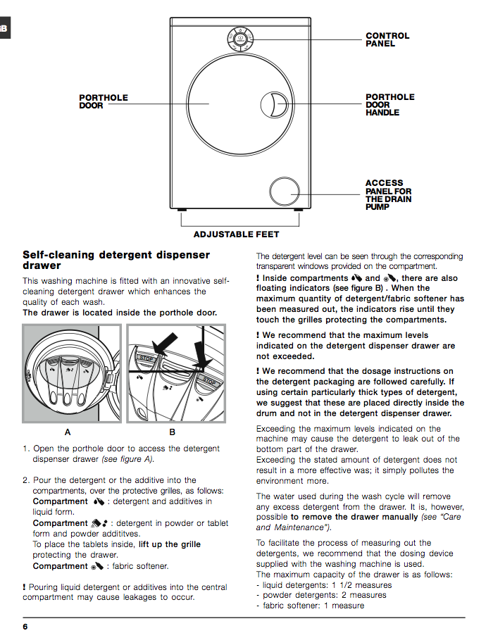

I found this pic online of how the moon dispenser works within the machine. I actually quite like them especially as it got a 5star rinse rating from which! but the only way i'd have one would be to stick a standard door on it and use 2 in 1 detergent in it. This picture led me to think, i wonder if the inlet goes straight to the top of the seal where it fills or whether there is still a dispenser chamber at the top of the machine where the dispenser normally would be. Does anyone know? Darren |

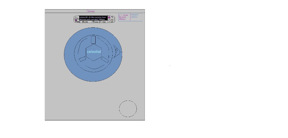

my version of the moon but this one has a hotpoint aqualtis esque soap drawer behind the door sorry about the writing being small Tom :) |

Darren The inlet water goes straight from the solenoid valves to the top of the door seal to the in door dispenser. Very much like the new Hoover Aquavision condenser dryers. Maybe alot of the problems with the lack of it being self cleaning on the moon could have alot to do with how low the water level is. The drum not being able to deeply flush hot soapy water around it. Like most machines low level wash & deeper rinsing levels. Indesit slipped up they should have provided at least a boil wash or a maintenance wash button of a 90deg high water level wash with fast agitation to give it a thorough clean through.

Tom: Nice drawing! I always said i'd have preffered the indesit moon if it was seethru plastic even if it was coloured I think it would've sold better or if it had the hotpoint extendia dispenser in the bottom of the door!
Optima: Thank you for clarifying that! Even if they didn't want the machine to do 90 there should have been a combination of buttons that would trigger a maintainance wash i agree. Darren |

Its clearly mentioned and also if using ultra thick liquids or cloggy powders to place these directly in the drum, the machine is also supplied with "Spare Sponges" so you can always have a spare dry one!!
