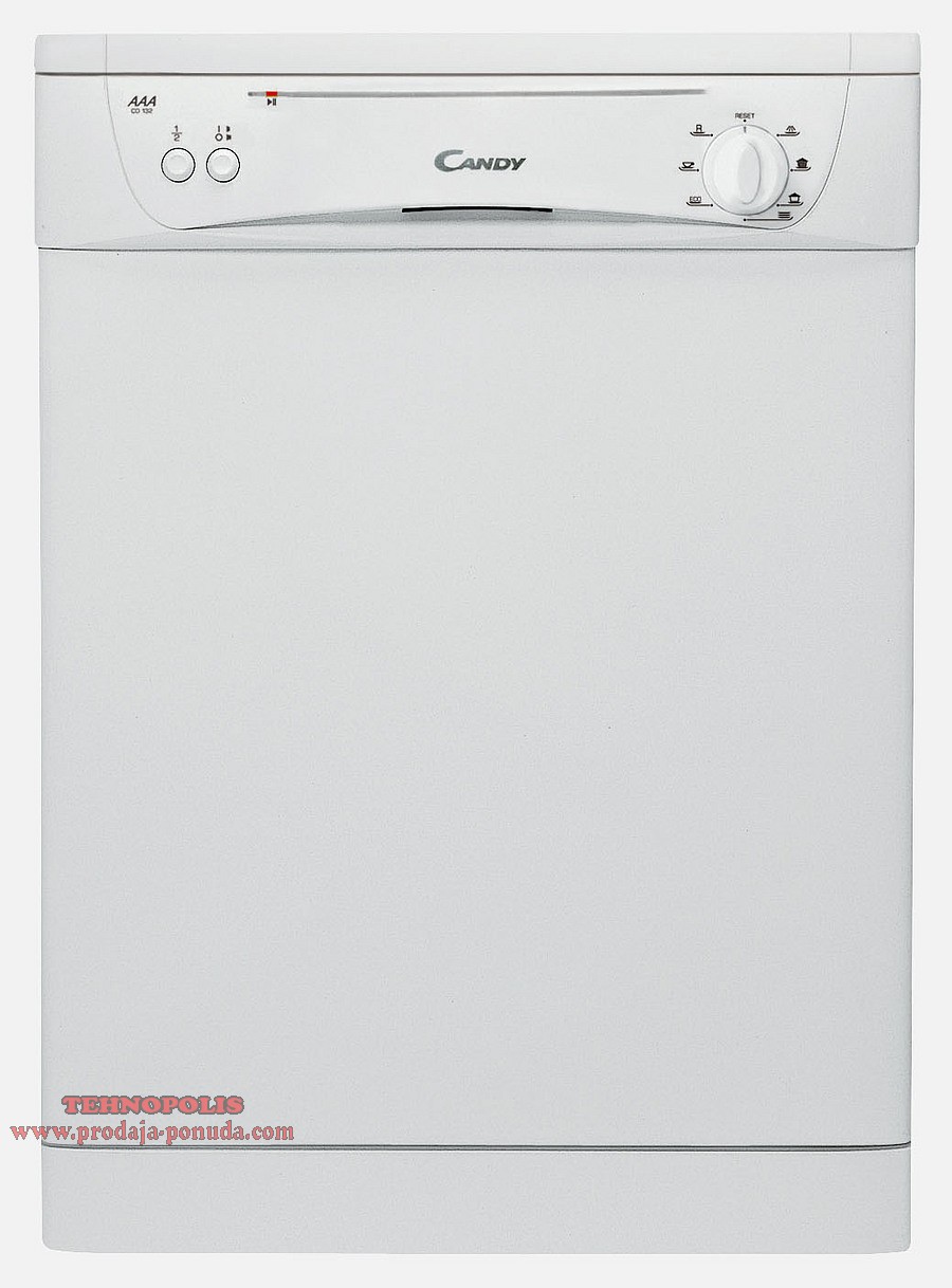

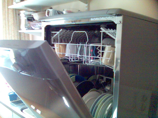

I experienced a strange happening some time ago (probably over a year ago) with my dishwasher (Candy Aquaviva)... I was all engrossed in the hassle and bustle of worktop cleaning in the kitchen when I heard a small electrical explosion... then another smaller one, I looked around and it seemed coming from the dishwasher but I wasn't sure. These little explosions were followed by a burning smell. I grew suspicious so I flipped the dishwasher on the floor and started to investigate trying to find any possible scorch marks around the components inside: I had no joy though as everything seemed to be in order.
My suspicion was totally obliterated by the fact that later on that day I found a blown out CFL light bulb in the kitchen. Today, after a considerable amount of trouble free dishwashing, the explosion and burning smells are back... the dishwasher was draining its last rinse water and the incident happened as the timer was clicking to its last position (for residual heat drying). This is ever so puzzling for me... I've never seen a drain pump fail in such a way! To make things even more puzzling, when I moved the cycle selector (mechanical timer) to a draining position the thing was still working fine :-& I'm willing to replace the drain pump as this is available online for about £30.00 but I wouldn't want to change the wrong spare part nor starting to throw money away as other potential failures might be in line as this appliance has given its share of service already. So, it might be time for a new dishwasher, still... any help would be mostly appreciated... should you have experienced a similar episode with a drain pump in an appliance. Many thanks every1 ;-) |

Post# 514751 , Reply# 3   4/30/2011 at 09:59 (4,836 days old) by foraloysius ![]() |
Is there something you wanted to make clear with the picture? I don't see anything special in it.

'foraloysius' the pic didn't have any particular purpose but thematic... just to make the thread look a little more colourful ;-) 'nrones' I will try to make a video, although it might not do it again next time... it might do it the time after that or who knows when, in any case... that means putting it on during the day or getting up really early :-P 'hoover1100' the dishwasher is on top of the washing machine. I'm still hoping that some of you might know what these symtoms could indicate and let me know as appropriate ;-) In any case, I've got another load almost ready for tonight and I'll post again to let you know how it's going. Thanks again every1! |
