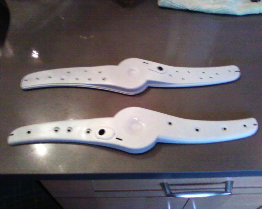

Gleen Here are the spray arms that you have... I got the first generation one from a system at work . Great Video ! Is that on Normal or Heavy cycle.... ? Being that Paykel Dishdrawers have Multispeeds spray for each cycle sprays hardest on heavy lighter on Delicate. Also the big hole in the upper part of the arm has a piece of metal in to deflect the water I beleave downwards to hold the arm in.. so it is not to fly off.

Normal cycle, first fill/prewash. Normal & Heavy run at the same spray pressure far as I know. Heavy is at higher temperatures. I have not visually compared the spray on Delicate, which is lower pressure. Lightweight items can get flipped over if not anchored, and some loads may be "noisy" due to items being jostled. I bought a spare-parts tub-home prism to trigger the infrared light tube sensor with the drawer open. Cycle times range from 38 mins to 132 mins, and may vary within that depending on water heating time. 12 mins for Rinse/hold. I think the revised arm cleans a little better and consistently throughout the tub area. It may be quieter, but the upper drawer runs a little quieter by nature. I should swap the revised arm to the bottom for sound comparison. |
Post# 519353 , Reply# 8   5/20/2011 at 16:52 (4,725 days old) by aldspinboy (Philadelphia, Pa)   |   | |
Thanks Gleen the sounds of the spray arms are definitely different. The one with the larger holes has a stronger sweeping sound in your drawer. The other one is much quiter thou you still here nice water sounds. I have a breakdown on the cycles, temps, promo stuff ,etc chart somewhere hopefully at some point I will post this. I'm so glad that your machines are standing up !!! F & P gets so much hell at times but I thank they can be an excellent companey when all the kinks are out.
