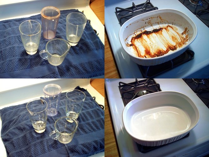

But try doing that without the phosphates, I'm curious at how the machine performs with standard detergent. |
Post# 519705 , Reply# 2   5/22/2011 at 11:53 (4,814 days old) by gmmcnair (Portland, OR)   |   | |
I know I get similar, great results with the Finish Powerball tabs. I don't need to add TSP or STPP in my water (it's very soft). My dishwasher BOL GE portable, and everything washes beautifully with the Finish, even stuff with baked on food residue. If I try the same test with standard gel, results are okay for most dishes, but not as sparkling.
Post# 519750 , Reply# 3   5/22/2011 at 16:11 (4,814 days old) by jerrod6 (Southeastern Pennsylvania)   |   | |
Wow Amazing performance from your Dishwasher. It cleaned the pants off of those dishes. I have Finish PB tabs but have never tried them with additional phosphates...maybe I will. Still your DW did a great job. How long did the cycle last? |

![]() Water heater: 120 degrees F. Cycle time: typically 2:15, never more than 2:45. We have really hard water so I've always used a booster (first Glass Magic [expensive, still contains phosphates], then Lemi Shine [ditto, no phosphates], now TSP [cheap in a 4½ pound box from Home Depot]). Next time I broil Brats in the CorningWare, I'll try a load with just a Powerball tab. |
