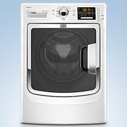

so far the only washer in the top load category offering a warm rinse is the fridgedair top load washer but the warm rise is actualy dumb down and unless your willing to buy a vintage washer thats dates from 1950 to the end of the 1990 all newer washer offers only all cold rinses in the top load models unless the he top load model have a warm rinse option but so far the only models of washer i know of that offers a warm rinse are front load washers. Like this model to be precise. or you could always look for a speed queen and ask if they could have on a special order a washer with a warm rinse option.

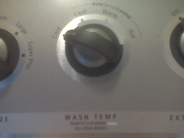

Post# 528934 , Reply# 4   7/5/2011 at 23:53 (4,671 days old) by StrongEnough78 (California)   |   | |
My friends one piece/stacked Kenmore unit that was like 5 years old I think, had the warm/warm option but the rinse still came out cold! I even turned the cold water off at the faucet and nothing came out at all. So I'm guessing the spray rinse during the spin between the wash and rinse cycles was probably warm and not the actual rinse cycle. Could that be possible? I was disappointed. The unit said Kenmore all over it, but it was definitely Frigidaire hardware. It had the solid vane agitator that did the half stroke one way and tub index and quarter stroke the other way.

I walked through the showroom and found three models that have a warm rinse option.
Maytag Maxima FL MHW6000XW LG WaveForce TL WT5101HW LG WaveForce TL WT5001CW We have a GE FL on the floor but I haven't been demo'd on it yet; I can't tell if it has that option. My factory reps tell me that one of the uses for warm rinse is when washing rubberized articles (bathroom or kitchen throw rugs, for instance), the warm water helps to prevent the shock to the material that can cause cracking/flaking. |
