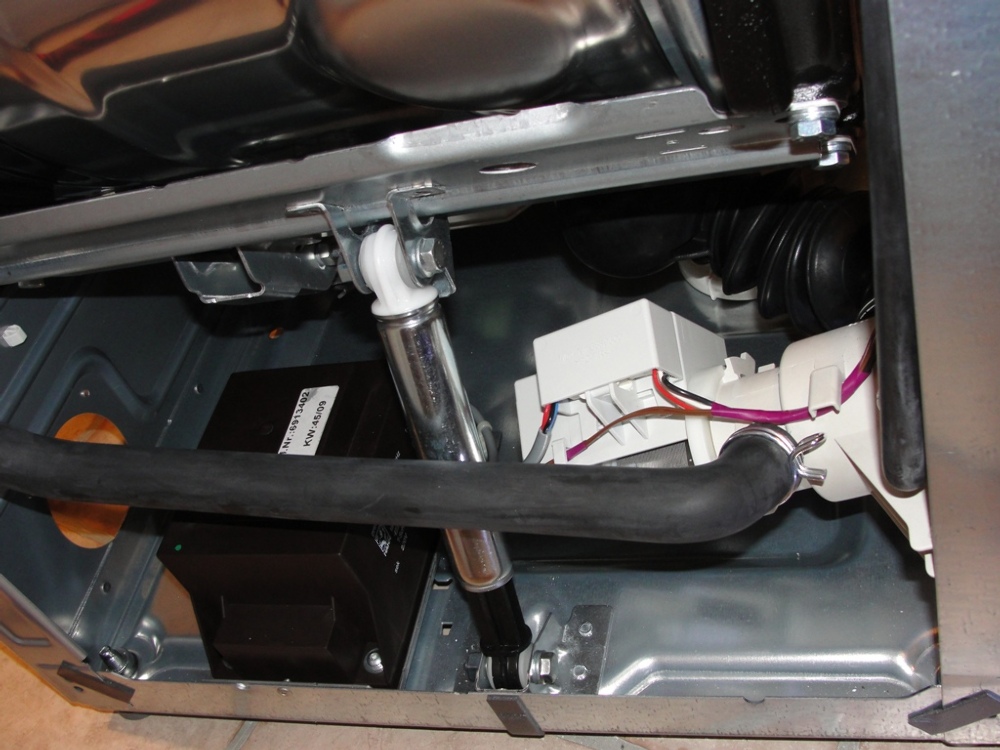

I don't know how you would do that on the W3033. I own one and it's all built for american 120V - there is a stepup transformer inside it that converts the 120 to 240. Some of the components run off 120, some 240 inside this machine.
Post# 534849 , Reply# 2   8/3/2011 at 20:22 (4,259 days old) by vacfanatic ()
Post# 534850 , Reply# 3   8/3/2011 at 20:28 (4,259 days old) by vacfanatic ()
Also note that the programming in the W3033 as shown in my video link only goes to 70C, and the W3033 only has 1 heater rated at 1060 Watts. I've also got the factory service manual and it does not have any information about conversion to 240V.

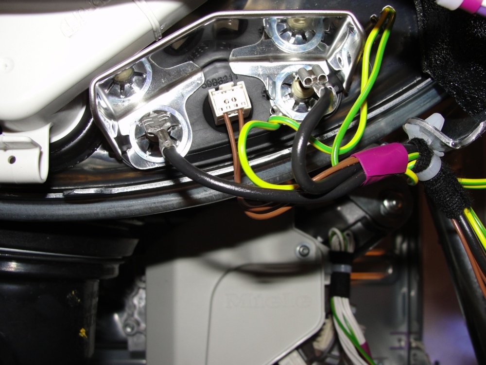

Thanks for all the pictures and the info, what I know is that electronic parts get one line at 120 and one line from the transformet as a neutral. the only thing that work at 120 is the heater. Miele will sell to me the 2100 Watts 240 Volts heater but they will not do anything to help me change the voltage.
So at this point yes it is possible to do it. It will be faster to heat the water and I'm not obligated to keep the water heater "on" all the time I wash. Plus in some short programs that I need hot water (60° or 70°) the machine will reach it. In some cases the F20 after a wash will come out so.... and plus a wash cycle will be cheaper.
Thanks again for you info.

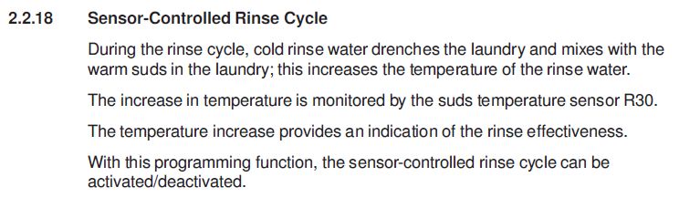

ps coud you please tell me what it means "rinse process" in the program list? I turn it on but I don't see the difference. Thanks
Post# 534878 , Reply# 5   8/3/2011 at 23:13 (4,259 days old) by vacfanatic ()
Add a relay.
Control/energize the relay with the 120v normally applied to the heater.
Get your 240v for the heater from outside the machine.

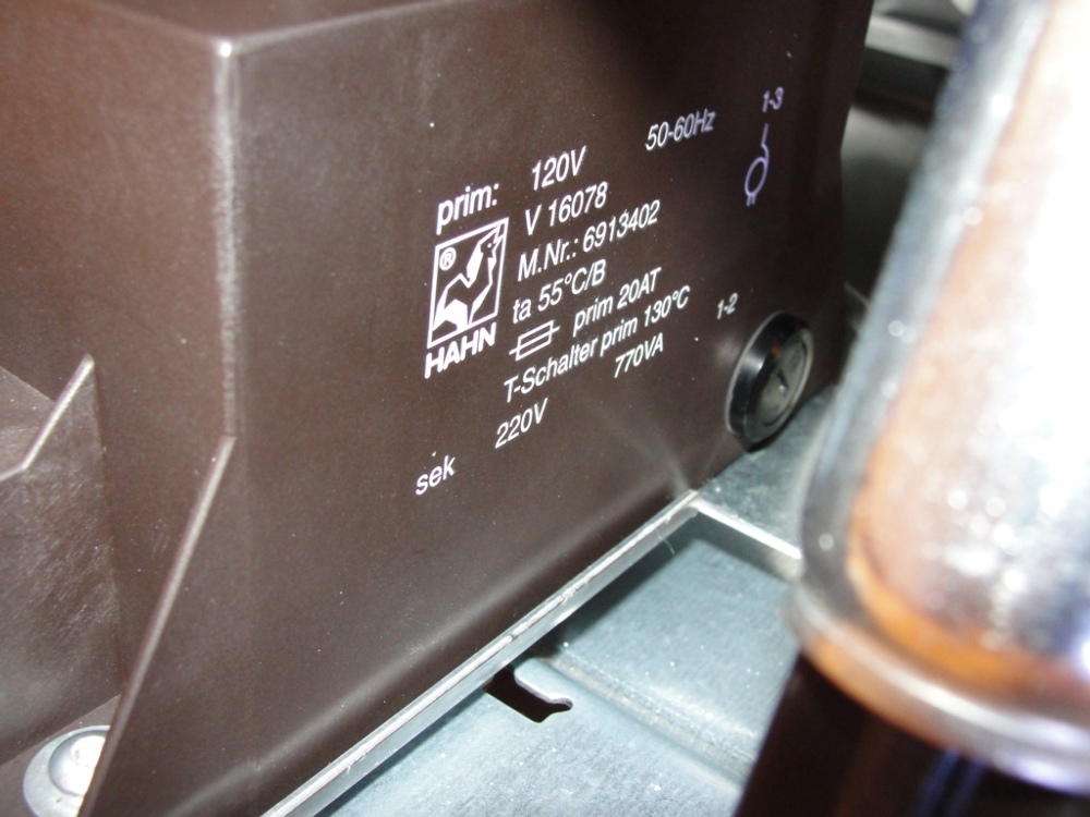

Remember that the electronics in the machine (the microprocessor and control circuits) will almost certainly run from 5volts and 12volts DC - there is another power supply inside, on the circuit board, that changes the 240v Ac down to 5v and 12v DC for the control circuitry. So it doesn't matter what voltage supply the machine runs from, the programming, including maximum temperatures, will remain the same.
It appears that this machine is made basically as a 240v machine, with a transformer to step up the 120v supply to 240v for the motor, pump, controller, other circuits, with only the heater element being supplied 120v direct from the mains. That heating element will already be switched by a relay.
In effect, you supply 120 volts AC to the machine. It then is fed through a transformer to supply 240 volts to the controller. (and motor, etc.) that 240 volts is then stepped down again to the low voltage control circuits (5 or 12 volts). They switch a relay which connects the 120v supply direct to the special 120V element. (NOT via the transformer.)
If you were to proceed to a modification to 240 volts, you would NOT need to add a relay, the existing heater will already be fed via a relay. You would have to check that the relay is rated for 240 volts, too. I would NOT attempt a conversion and advise you to drop the idea.
