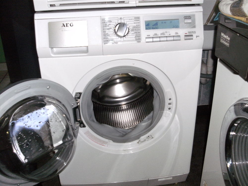

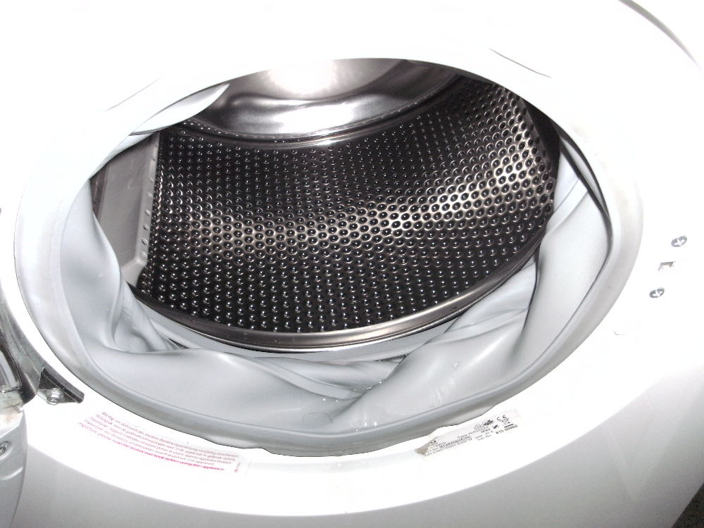

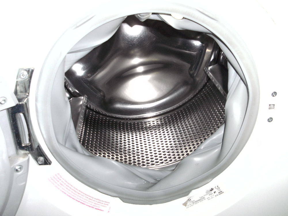

strange problem with the aeg |
Post# 537322 , Reply# 1   8/16/2011 at 09:53 (4,728 days old) by targus ()   |   | |
picture ![]() |

Post# 537325 , Reply# 4   8/16/2011 at 09:57 (4,728 days old) by aegokocarat (United Kingdom)   |   | |
verry odd, i would still get the seal changed as to avoid it grating against the drum :) Tom |

Post# 537330 , Reply# 6   8/16/2011 at 10:17 (4,728 days old) by lemniscate (United Kingdom)   |   | |
It looks as if the boot has moved on the front panel and become twisted. Anyway to twist it back what looks like anti-clockwise. Just a thought. |

what the hell??? what was it like on the spin cycles and does it make any funny noises or anything? looks really wierd lol |

Post# 537386 , Reply# 10   8/16/2011 at 14:58 (4,728 days old) by ozzie908 ![]() |
If you remove the top of the washer you should find a worm drive on a large band of metal that goes around the seal against the drum, The outer edge looks fine as that would have been pressed by the door. Just loosen the worm drive screw or if its a plastic ring you may have to remove it, Straighten the door seal and replace the ring/clip should be as good as new again.
