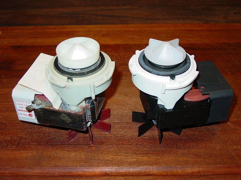

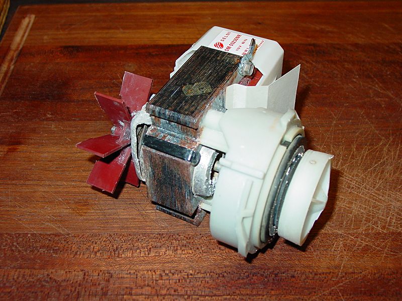

60 years on a Bendix pump with no repairs is fantastic! Hey Jon, several years ago you asked me to call you regards to questions on an F&P washer that your sister had bought. How's she doing with it? Or has it been replaced by now? Just wondering ... Here's a pic of the culprit. Toy-looking little thing. Made in France. It was under water for about 12 hrs during a flash flood in Nov 2004, still worked after. |

I put off ordering the new pump for a while, in case Sears had the best price on anything I needed for the Catalyst dryer. I thought F&P parts are hard to get?? Placed the order online Monday 9/12/2011 @ 5:30 PM. Item received on WEDNESDAY 9/14/2011 at 1:00 PM. Sent from a warehouse location in Dallas. Standard shipping (although it was an outrageous $11), not 2nd-day or overnight. The impeller is different, supposed to run a bit quieter, I believe. This is the replacement listed for GWL08, although it's not the newest pump design that includes a fuse to be added on one of the pump wires to protect the control board (which would also work on GWL08). |

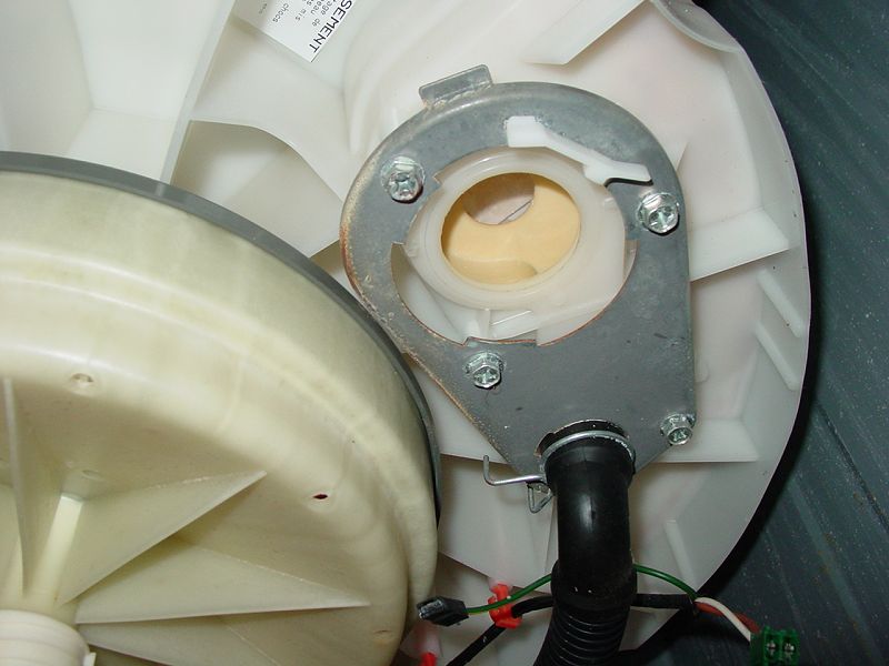

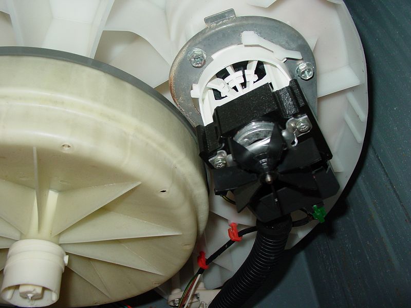

Well ... damnit. Turns out to be the wrong pump, by one digit. 420324P is 230v/50hz for non-US power. Correct item is 420325P. The parts diagram @ Sears for GWL08 lists the wrong item. I didn't cross-reference it against the docs I've gathered via scouring online. Duhh. And even more duhhhh, I didn't run the new pump "dry" before putting water into the machine. Must call Sears to get an RMA but they're pretty nice to deal with. There's a "click to call" function on the site which brings up a window to enter my phone number for THEM to call ME. Phone rang within seconds before I could get the number submitted, so it apparently was picked up automatically from my customer profile. Anyway ... here's a pic of the bayonet mounting bracket. No tools needed to change the pump. |
