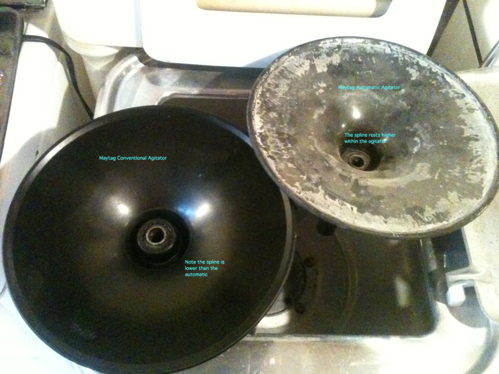

Hey guys -
Sorry to be a bummer, but an Automatic Maytag agitator (either from an AMP or Helical) will not work on a conventional Maytag. The spline rests much lower on the conventional agitator. An Automatic agitator will slide on to the conventional's transmission shaft, but the spline rests too high within the agitator to reach the stop ring on the shaft, thus the agitator would float up off the shaft during wash or scrape the bottom of the tub. More than likely the best way to find a lint filter agitator for a conventional Maytag is to find a Maytag wringer with one installed. Ben ![]() |

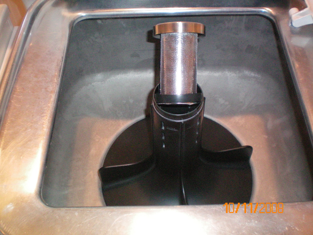

Lyle - beautiful example there! Usually it was an 'upgrade' during the sale of the wringer. Your mom was a lucky woman!

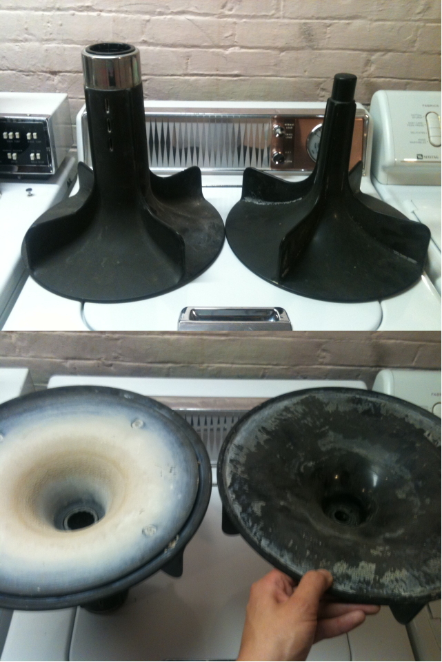

Your picture also shows something that most photos don't - The lint filter agitators for the wringers have a Water Level line mark towards the top of the agitator. The 1955 - 1965 BOL skinny post and 1957-1965 TOL lint filter agitators do not have a Water Level line due to being in automatics (note the skinny post agitator in the photo below does not have the Water Level mark). Here is a photo showing both versions of the Bakelite automatic agitators available before the Power-Fin agitators. Completely interchangeable within Helical drive automatics, but will not work in wringers. Martin - I'm not sure what example you were looking at. The skinny post agitator was used in the Highlanders, and the lint filter version was used on the Super Highlanders and the All-Fabric TOL machines (pre-65). Hopefully this clears up any confusion. Ben ![]() This post was last edited 09/20/2011 at 22:01 |
